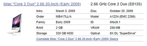

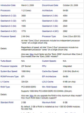

This is the specs of my system:
iMac A1224
EMC 2266
P Socket 478 pin chip
Link to everymac: https://everymac.com/systems/apple/...o-2.66-20-inch-aluminum-early-2009-specs.html
Long story short, I want to change the CPU of my system. Is this cost efficient, or smart? Not really. Do I care? Nope ;-)
I found a CPU that would fit in the socket and that matches the type.
Here it is: https://www.ebay.ca/itm/Original-In...e=STRK:MEBIDX:IT&_trksid=p2060353.m1438.l2649
What is interesting is this is a really obscure CPU, one of the only quad cores for this socket. I confirmed with the seller, they are both the same. Big Question for you guys: Will my iMac post with this CPU? Will there be EFI issues? And if so, is there any way around it?

As far as I know, Apple have never released a Mac with a Core2Quad (Kentsfield/Yorksfield) processor.
Based on that, there’s no reason you should expect it to work. There’s no EFI support or OS support for that processor.
However if you’re happy to risk making a lemon out of your iMac, there are many here (myself included) who would be interested to see if it works.

Well, aren't both the Quads and the Duos Penryns? In that case, since it's the same architecture, wouldn't it be necessary to explicitly blacklist them rather than whitelisting them from the EFI?

That comment was more oriented towards other people more knowledgable than me. I'm no expert either, but as far as I can tell, both the Core 2 Duo and Core 2 Quad in question are the same architecture, and so for one to work in the motherboard/EFI and not the other would be more work (explicitly disallowing it).
I don’t think the EFI should be an issue, considering the chips are the same architecture and from the same series. At worst, I reckon the EFI might not be able to read the last two cores. I might be wrong of course. OS X support is probably fine, OS X supports quad core Penryns (as in the Mac Pro), and there are many Hackintoshes that use Core 2 Quad chips too.
