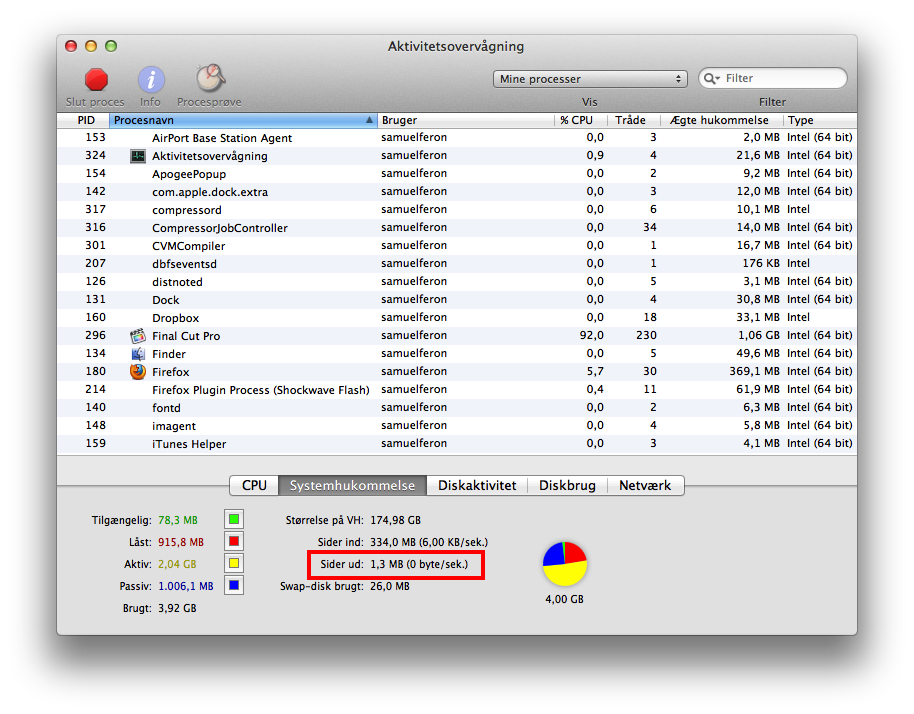

When your rendering a video, check the activity monitor for "Page outs" If this increases then it's likely bottlenecking rendering speeds due to having to read from the HDD and place data into the RAM. This gives an idea of whether you need more RAM.

That's typically what it would look like when rendering. It was actually increasing at one time. The red square indicates page outs. As you can see, there's not much free ram.

Your activity monitor clearly shows that with that usage you don't need anymore RAM 1GB is free and swap in the low MB is as good as none.

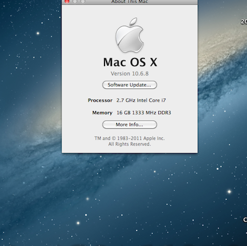

AntJon82 --> Can't get 16 GB on my mbp, max capacity is 8 GB...
Are you sure? If so, then you have that one 2011 MBP with that limitation it seems.
What! That would be unlucky... I don't know, according to this link it seems like it though, right?
Look here for more information. Apple does not state the real RAM limit, which is 32 GB, but only 16 GB can be used right now due to only

Aaah, I see, it actually has room for 16 GB. Now I just need to find out what would be sufficient. 8 or 16...
