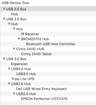

Hi, The late mac mini 2018 model is now on the way to me and I really don't want to have "buyer's remorse" lol. While everything I've read about the late 2018 mac mini i7 core sounds perfect for me, I wonder how I'm going to use *all* my peripherals since there will be less usb ports. I'm currently using usb for my printer, scanner, keyboard and cintiq connections--please see attached screenshot of my usb tree. Can anyone else relate to this scenario? In order to get the most bang for my buck w/ my new mac mini would I need to get a new usb hub? If so, any recommends? Thanks, in advance, for your feedback!

Remember that the 2018 mini has 2 USB-A port while the remaining are TB3/USB-C ports.
So, if you need to use more than 2 devices with USB-A connector you will need to use a Hub or adapters to USB-C.
Consider also that some USB 3 devices plugged in the USB-A ports may interfere with Bluetooth (this may cause problems, for example, with magic trackpad/mouse), someone resolved with issue buying a USB-C hub (obviously able to connect also USB-A) with a cable long enough to avoid interferences.
My experience (from a 2009 mini to a 2018 mini) : I use the old Apple USB keyboard (USB-A) plugged in the mini, sometimes old USB 2 disk connected to the other port, old Magic Trackpad and I have no issue. Keep in mind that the keyboard is also a USB hub (it has 2 USB 2 type A ports) and I use it for an old USB sound converter (I use it just to use my old headphones). With this config I have no issues.
I observed issue with Bluetooth only when I used one of the mini USB-A ports to plug a USB 3x SSD disk (issue solved simply using instead USB-C)
another great thing to remember is the USB A ports are only 5g on these mini's , most usb c hubs too are only 5g with the exception of a few. so keep that in mind if you are driving several SSD's off one port.
a thunderbolt 3 dock can give you single tb3 port to many usb c 10g / usb a 10g but they are pricey.
the 4 tb3 ports are also shared over 2 controllers, incase you plan on a eGPU.
