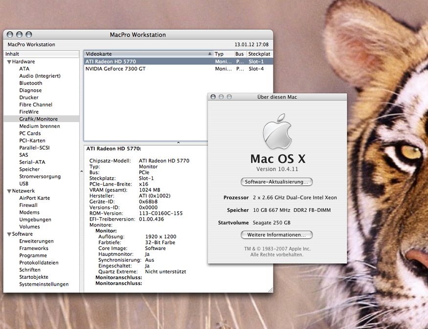

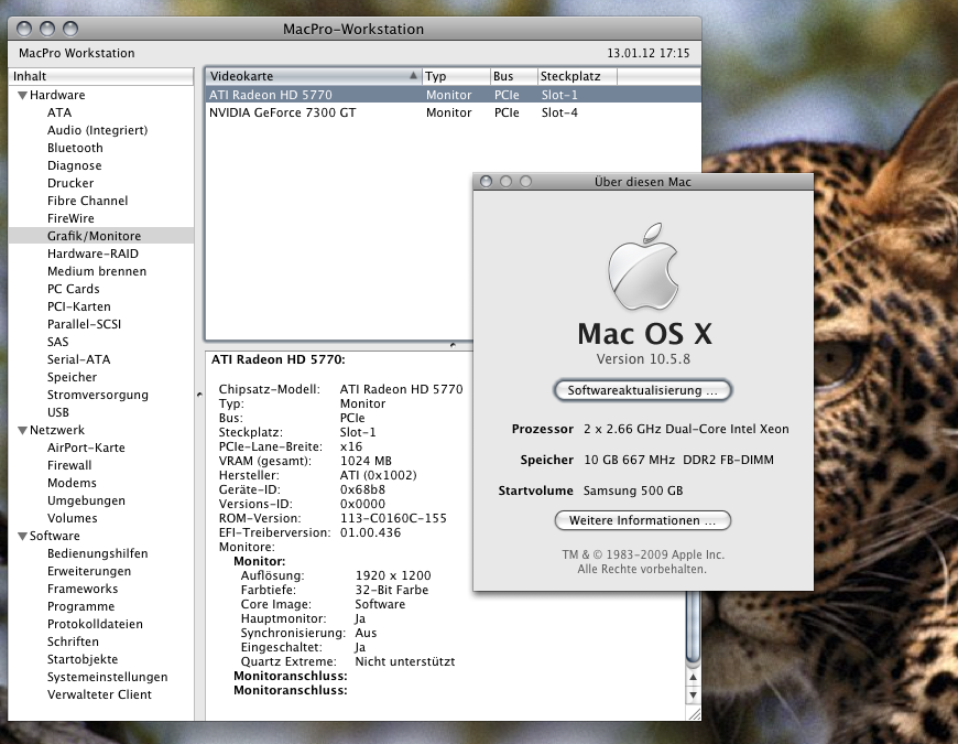

I have a slightly OT question though, just out of curiosity. Reading this thread, I wonder why it's possible to start my MP 1,1, running the ATI as main GPU, but using another startup disk w/Leopard 10.5.8? The machine will even boot from a 4th disk and 10.4.11 Tiger?
Is that because the original NVIDIA 7300 GT is still inside and funktional, moved to slot 4 but not connected to a monitor?
Anyone? Pics or it didn't happen?
I have added 2 screenshots.
Btw I hope this question is not considered inappropriate for some reason, or even a thread hijack? 😱 If so, I'd like to apologize to the OP.

without any tweaks? that's pretty nice! usually unsupported cards will boot 1024x767 (just "generic vga driver") which you can get to 1920x1200 with some tweaks.
no quartz extreme enabled, so you won't get anywhere near full performance. still not supported 😉
I believe it's a different story when booting DVD's, they tend to just KP instead of using some generic driver. atleast did for me when I used MP 1,1 restore disc from 2006 with nvidia 8800gt released in 2007
without any tweaks? that's pretty nice! usually unsupported cards will boot 1024x768 (just "generic vga driver") which you can get to 1920x1200 with some tweaks.
No tweaks.
You're right of course. 🙂 Wish there were ways to enable it..?
Maybe just good to know anyway. QE support is not a must for all applications.
Thanks for answering (and all the R&D you do and share btw).
