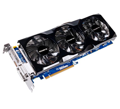

My card:
Gigabyte 6950 1GB Windforce OC. Super quiet.

My card:
Thats an impressive card. 😎
Is it pretty stable in your Mac and do you think it would be a viable option in my MacPro 3,1?
Also, would it need flashing first?
Cheers
David
