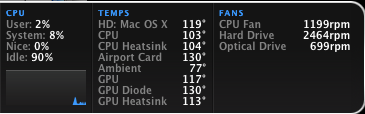

I'm attaching a screenshot of mine now, with HDD fan running at 2400 rpm just to get HDD at 119 deg. Machine is pretty much idle, with exception of using Safari and downloading two files.

thank you, imac22, this is the just the kind of meaty data I hoped to find. I was thinking more on the lines of WD's "green" hard drives, which are supposed to run cooler and quieter - sounds ideal for an iMac - though they're presumably not quite as fast as the the Caviar blacks.

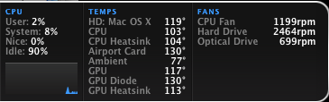

Hello I wanted to take a screen shot of my iMac data to see if people are getting similar results. It seems rather hot to me...

Just thought I would add, that I have upgraded the HD in my 2008 iMac twice because of running out of space, had a 500gb drive at first, then put a WD Caviar Black 1Tb and now have a WD Caviar Black 2Tb, I have never yet had a drive fail in my iMac, however I know others who have.

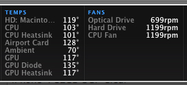

These are my temps, I dont bother with SMCFanControl, just let the computer do its own thing. What is interesting that although my ambient temperature is lower, my hard drive is running at the same temp as iMacs22's with his HD fan spinning higher and as he says a fan pointing at the iMac itself.
I currently have iTunes playing, Photoshop open, Safari browsing, so not really doing at lot.
