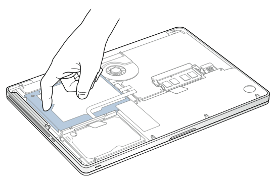

From MBP manual:
"Touch a metal surface inside the computer to discharge any static electricity from your body."
