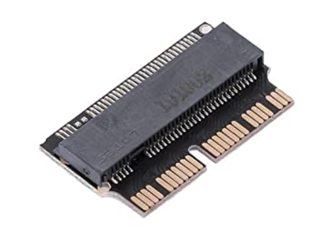

I have a MacBook Pro Late 2013 15” Retina model (8GB RAM, i7, 2.0GhZ processor with 256 GB flash drive).
Can I replace this flash drive to 1 TB NVMe 2 SSD (with the below converter which is compatible?)

Will it have any performance impact or will it support 1TB without flaw)?

I don't know whether that SSD would work. It looks quite different to the stock SSD.

I saw some videos in YouTube which shows the process of upgrading the SSD in Late 2013 - Mid 2015 MacBooks which has this Flash Drive type of SSD.
Since the Flash Drive SSD which is compatible for Mac is very costly they are trying to use NVMe M2 SSD which is comparatively cheaper and surprisingly faster. But since NVMe does not fit the MacBook Pro SSD slot they are using an adapter as shown below, so that they connect the NVMe M2 SSD into this adapter which will then fit into MacBook Pro SSD. And they were able to install the Mac OS successfully.
