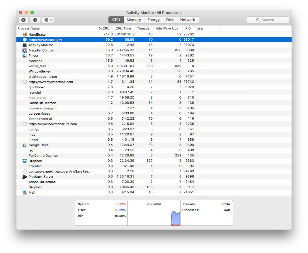

Anyway, if possible, open Activity monitor when you are working on your 3D software. If you see something like this (one of the process stuck at ~100%), then most likely you are CPU speed (single thread) bottlenecked.
