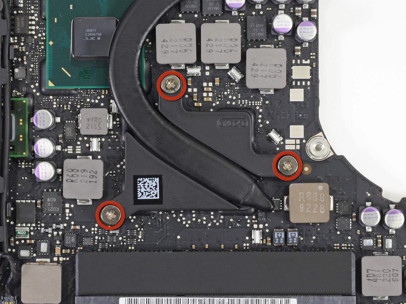

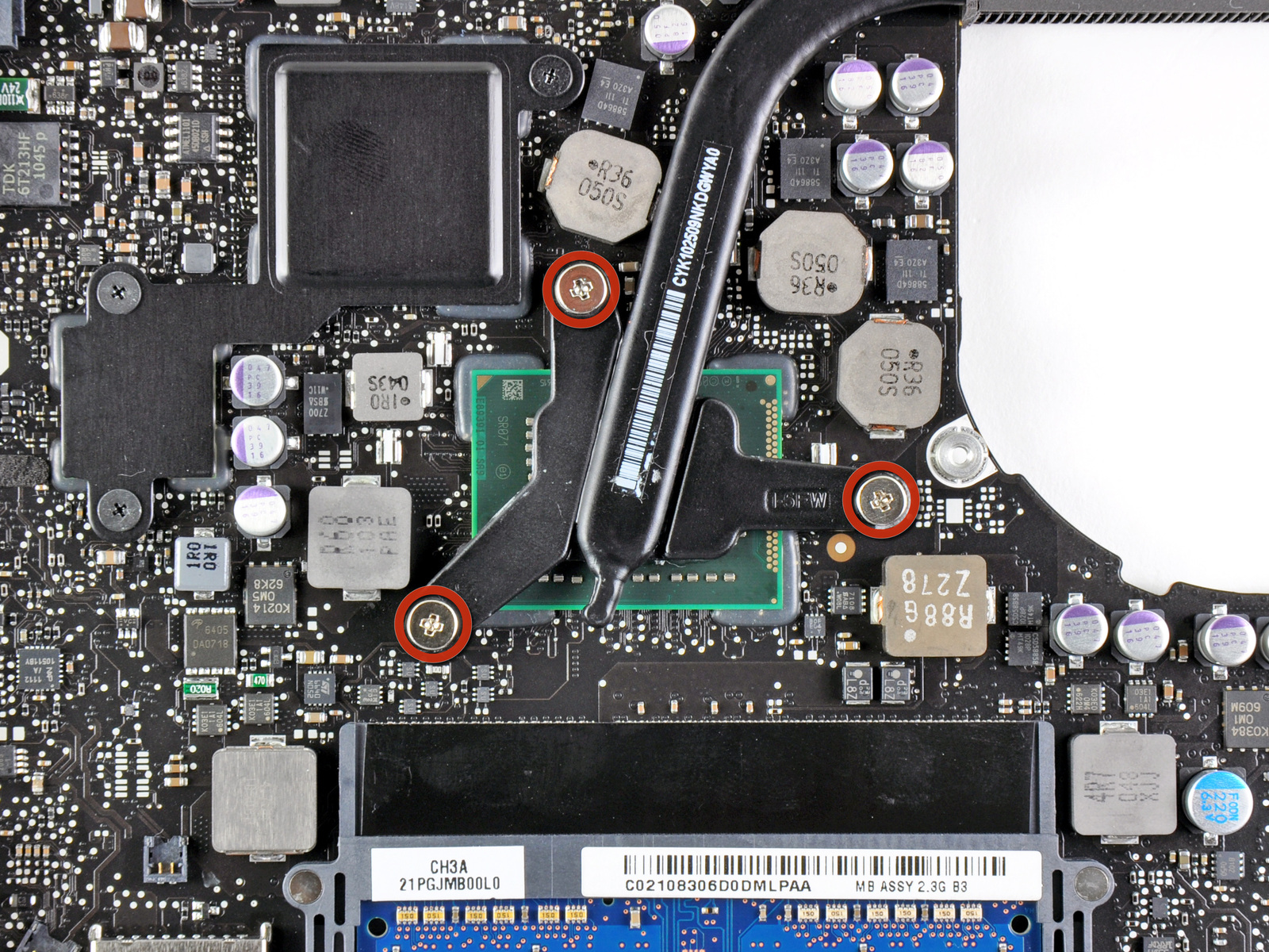

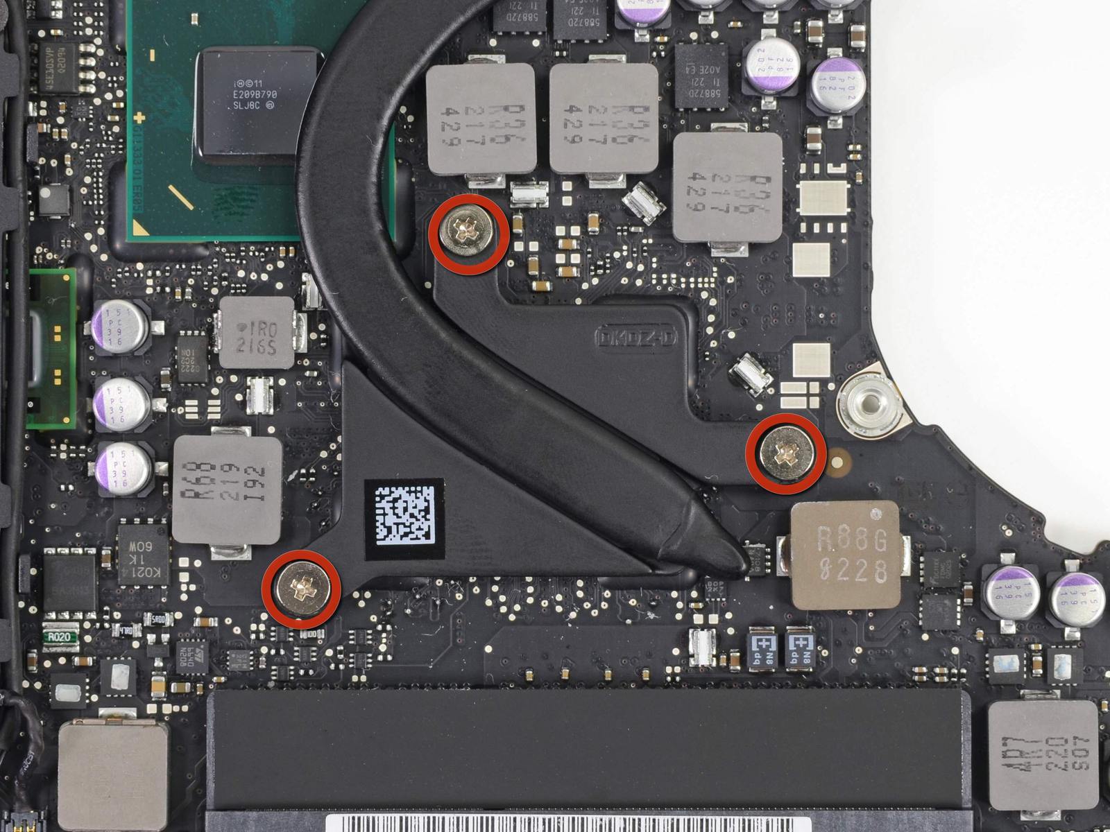

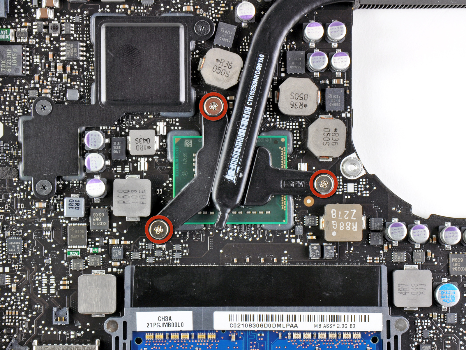

If you look at the iFixit guides for both machines (I looked at the late 2011 13" and mid 2012 13"), it looks like the heatsink mounting may be different. Look at step 27 for both. Also the heatsink routes across the board different, so unless you get it with the board you'll be SOL.
Yes I did notice that, it seems that the screw mounting points for the heatsink are the same so if I could source the heatsink I may be able to replace it however the images I have come across do not show more of the heatsink.

The fact that the 2011 and 2012 display assemblies are different parts makes me think the logic boards are not quite interchangeable. The top cases seem to be the same, so the board would fit in place, but the display cables or Airport antenna cables could have slightly different lenghts, if they are routed differently.
Ifixit seems to use same pictures for its guides of both models, so they are likely very close. It's hard to say if there actually would be visible differences, if they used different pictures for each guide 🙂
