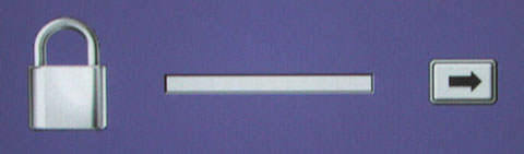

which was repeated over and over throughout the screen. The second time I rebooted, I got a different error (usb related, don't remember the exact error) and the third it somewhat booted, but I saw a lock of the left, a button with a right arrow on the right and a line in the middle. If I click the button, nothing happened. The fourth, fifth, sixth, etc, boot were the same as above (code=700), but different codes.

I have the 600mhz board in. I turn it on andhold down option+command+p+r to clear the PRAM, when I see the folder icon in the middle of the screen i lift command+p+r and only hold option. This brings up a screen with a long, a text field and a button with a right arrow. The text field is for a passowrd, although I do not know what the password is. I've tried several different passwords that I could have set. The wierd thing is I got in with a password (that's not the wierd part, I'll explain the rest after), and it brought me to a white dos screen (i know it's not does, but it's an input screen, like dos) that said type 'mac-boot' to continue booting. So I typed it and got a wierd DEFAULT CATCH! error. I rebooted, while holding down the option key and it brought me to the lock and password screen again (this is the wierd part). I enter the password I used before and it didn't work. I keep trying different passwords and they don't work. Finally it works, but it's a different password than what I used the first time ??? Anyhow it brought me back to the white input screen again but this time, it was constantly printing out indentical DEFAULT CATCH! errors over and voer. I had to turn off the mac for it to stop. When I rebooted again, and came to the lock/password screen, I can no longer enter a working password that will bring me to the input screen ??? ? WTF?!!
All is good! Now you only have a software problem. The white screen is "open firmware". There is nothing you really need to do there. Usually you have to hold cmd opt o f, for it to come up.
To clear the password you are going to need to boot up from an install disk. Pop it in, hold down c. Under the utilities section there will be a tab to change the passwords. I would set it to blank until you get everything going. Hope that helps.

btw, this is the password screen i get. Is there a default password?

ok I got the cd out by holding the mouse button. Does the boot cd have to be an install disc? I have a bootable disc with iPartition on it. I know it works because I've booted from it before. But when I hold c while botting with it in the drive, it doesn't load. thats why I ask if I need to boot from an install disc for it to do anything.
The install disk is so you can wipe all the passwords that were previously on the hard drive. Also have you tried just hitting enter when the password screen comes up. I just leave it blank on some of my laptops.
yes I tried leaving the password blank.. didn't work. I'm going to try to get a hold of the tiger install cds
