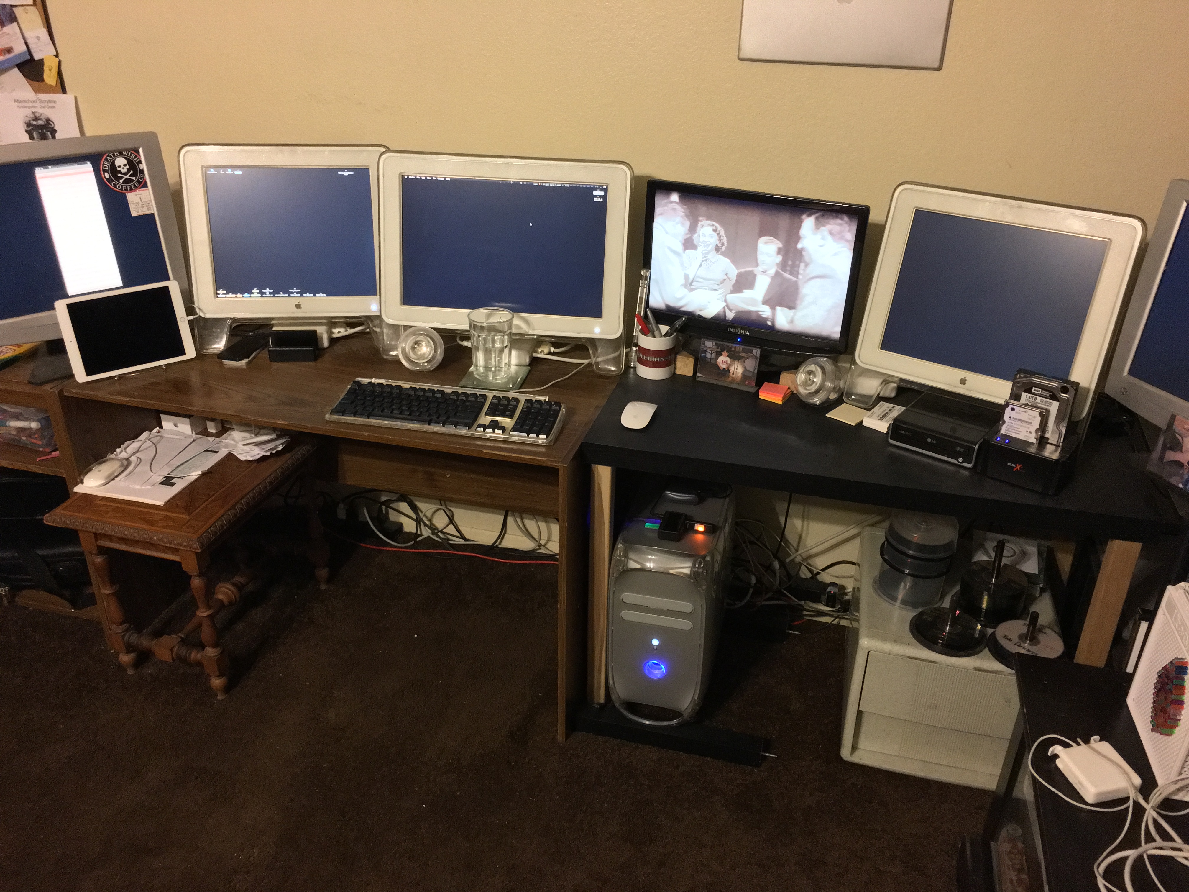

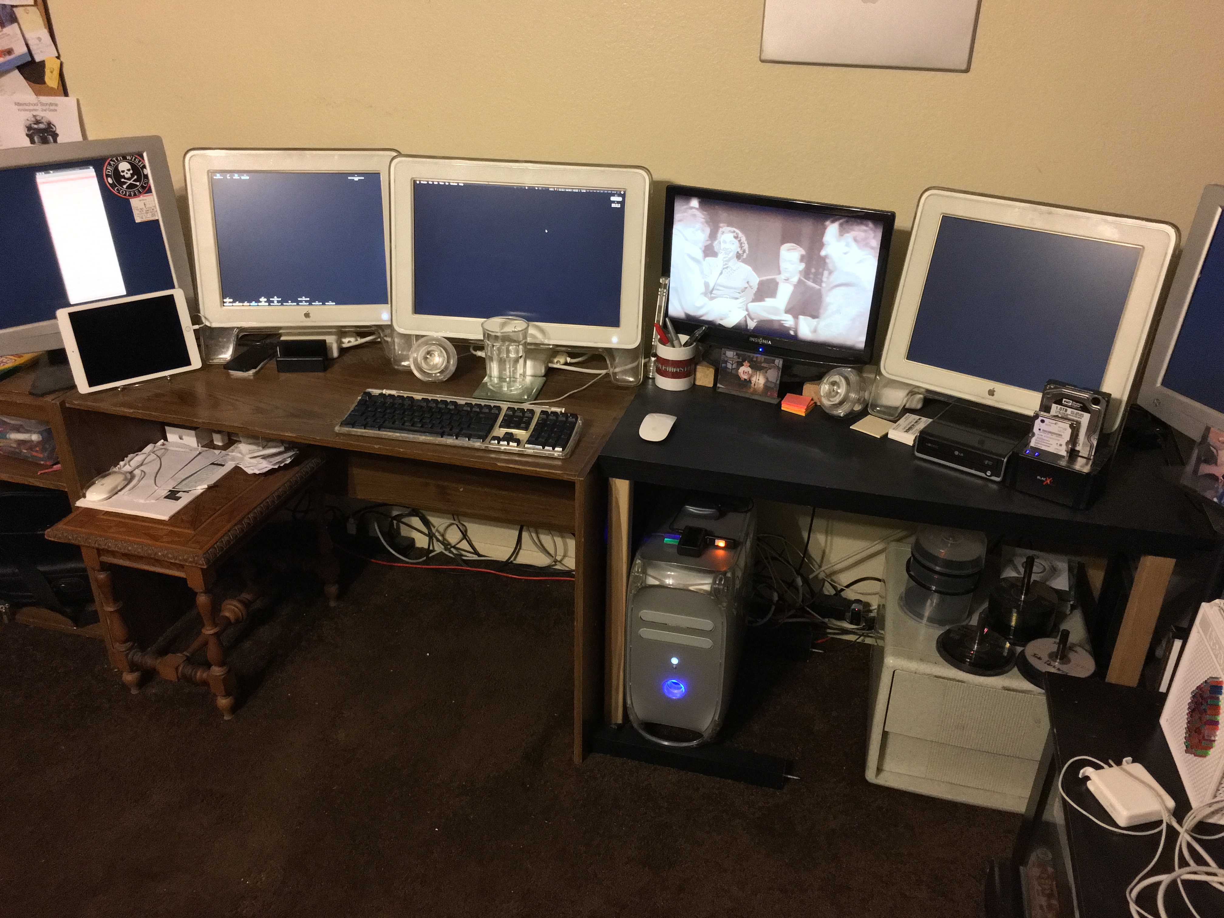

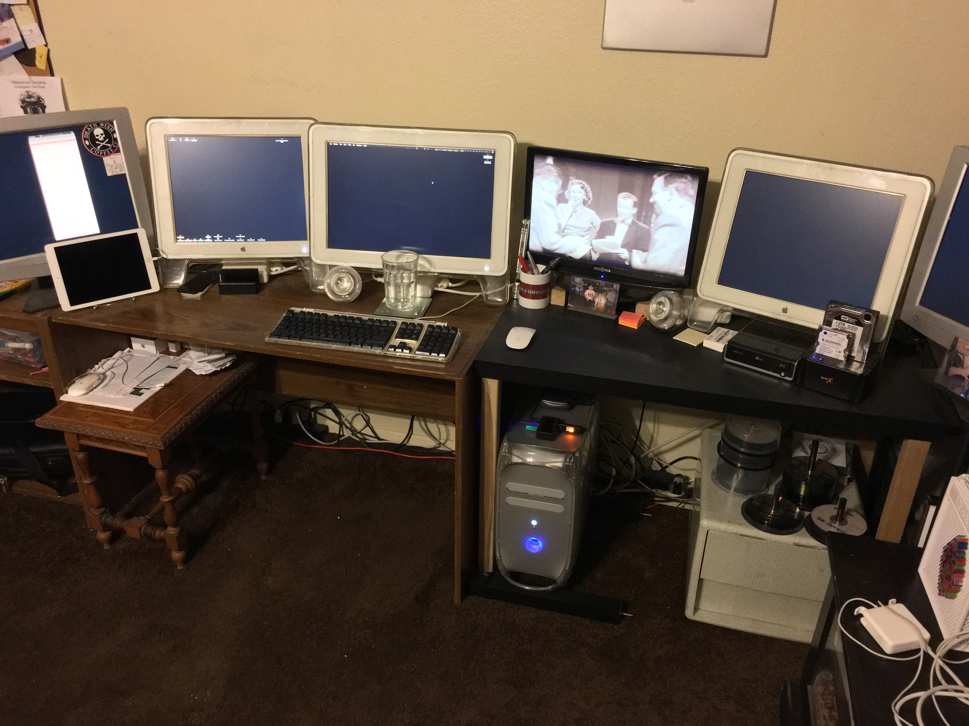

Below, my own Quicksilver.
1.8Ghz Dual processor Sonnet upgrade, 1.5GB ram, 3.6TB of SATA hard drive space (SATA PCI Card), USB 2.0 (USB 2.0/FW 400 PCI card), Bluetooth 2.0 (USB adaptor with Magic Mouse) and six displays (NVIDIA GeForce 6800GT, Radeon 9200, Radeon 7000).
About 1352 or so on Geekbench 2. :D
You have a Sawtooth and the same upgrades I've done are possible with yours, but you'll beat me with the ability to have 2GB of ram.

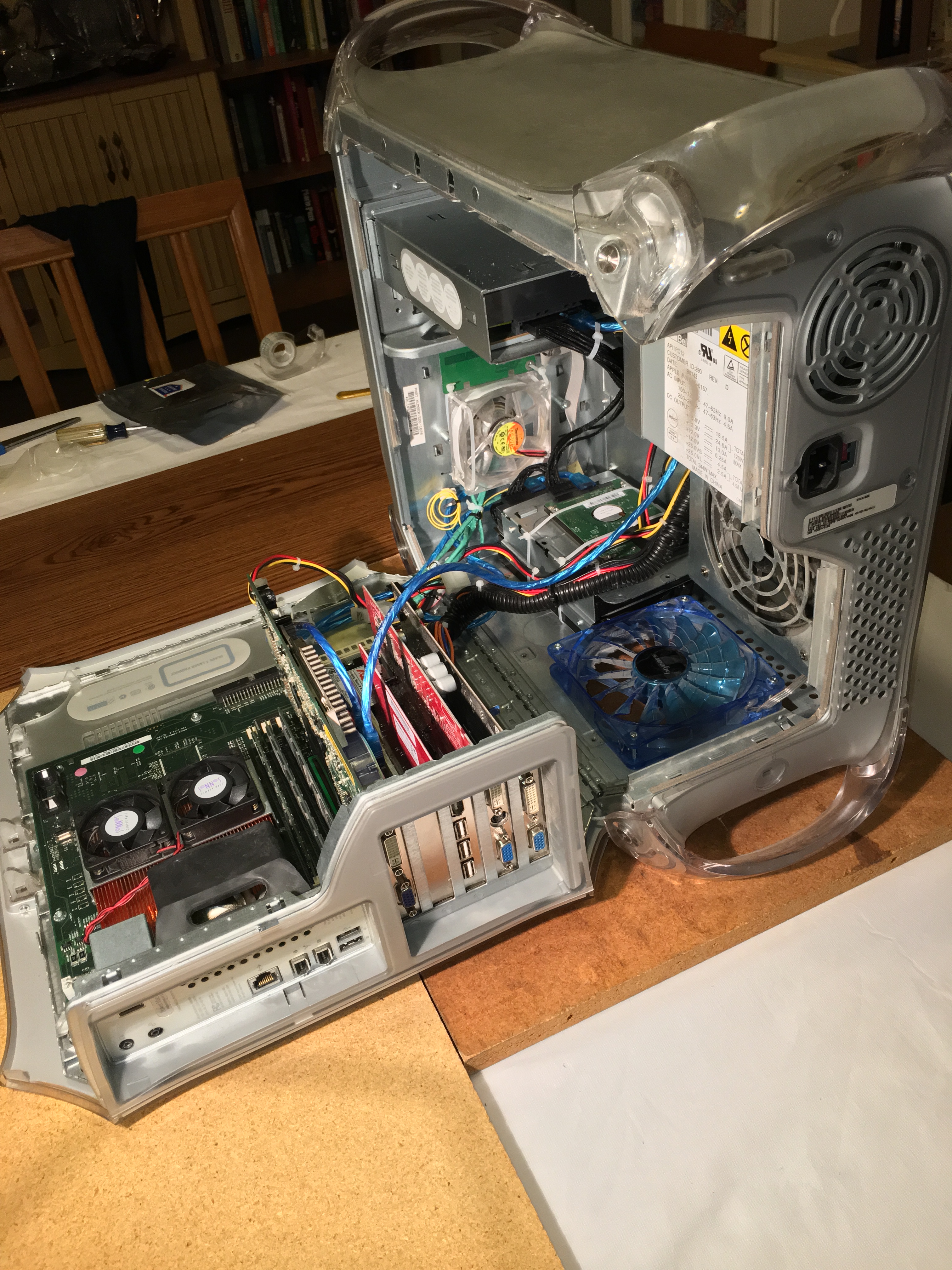

Currently I have nothing in that space because of the large amount of heat my Mac produces. I've stripped out most of the non-essential internal structural parts to make room for fans and allow for better cooling. At one time I thought I'd stick a second optical drive bay in there but everything I've got in that case is so tight now and I have a lot of power demands already so I've left that space empty.
