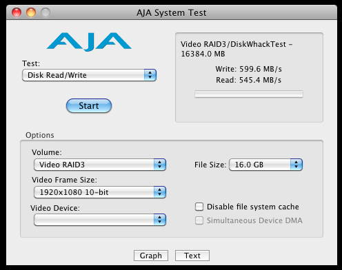

First RAID3 test with AJA: (screenshot attached)
I chose read/write 16GB test with video frame 1920x1080 8-bit.
Not terrible, but I'd have hoped for more.
Of course, you can always take one of the Hot Spares, and make it an active disk (leaving 1x Hot Spare) via Online Expansion.
But I still think you'd be better off with RAID 5 (same fail-over as RAID 3).
BTW, you don't work with 10bit?

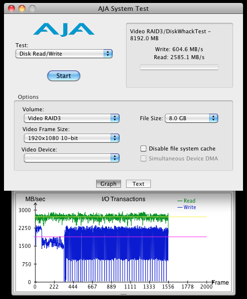

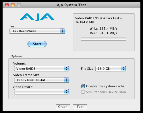

And test with the cache active, and watch what happens. 😉

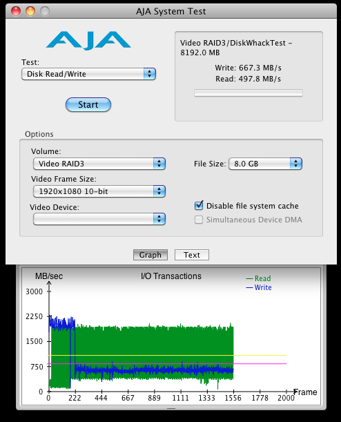

What I'm seeing is that there are these consistently terrible numbers in the same areas of three different volumes, using Xbench. When I run the AJA test on all three, I'm seeing just a simple set of numbers (write / read) and they're pretty consistent.
AJA tests:
- 640GB single internal drive = 90MB/sec both write/read
- 3x1TB RAID 0 = 315MB/sec both write/read
- 6x2TB RAID 3 = 603MB/sec write, 550MB/sec read
Basically, I've done what I set out to do, which was greatly increase my capacity, speed AND reliability. I think the Xbench tests messed with my head somewhat, with those weird 4K numbers. Areca tech support has assured me twice now that the 1880ix-12 has 16 ports (that the 4 on the external are not sharing any differently than the 12 internal ports, as they all come from one chip.) So even though I'll definitely test for a difference with the second internal cable, I will still be happy if there is no change. I'd like to see it improve, but I think I'm in really good shape!
I'll also try the RAID 5, just to see how things go, and follow up on all of this.

Update with two internal cables vs. one internal, one external:
AJA test @ 1920x1080 10-bit:
- 6x2TB RAID 3 = 625MB/sec write, 551MB/sec read
So, slight improvement, but probably just coincidence, not actually faster.
Cache Disabled or Enabled?
Enabled. The write speed bounces up and down, apparently, but here are screenshots of the same test back-to-back just moments ago...
They do vary, but it's a bit odd that the write values went up with cache disabled, even if wasn't by much.
I picked the 16GB test to get the longest run. It also depends on if I'm still running Firefox, I think. If I do the 8GB test, the read numbers are up in the 2000s or so, and the writes are in the 700s... watch this, I'll do it and post up...
Here's the same test with 8GB files instead of 16GB.
