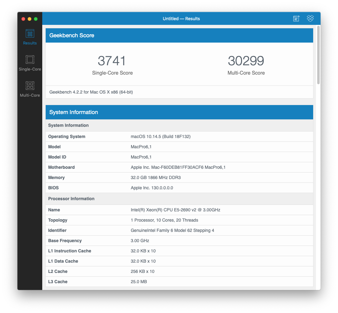

I did the CPU upgrade to the 10 Core Xeon and I'm pretty happy with the result.
Since I work with audio there is no need for me to get a better GPU. So unfortunately I can't help you with that.
I like the 10 Core for the good compromise between single core and multi core speed.
Also with more cores the speed of the internal SSD drops a little due to the PCIe management of the nMP 6,1.
There was a thread somewhere on macrumors about it.
This is my geekbench 4 score in 10.14, it's quite close to the 12C:

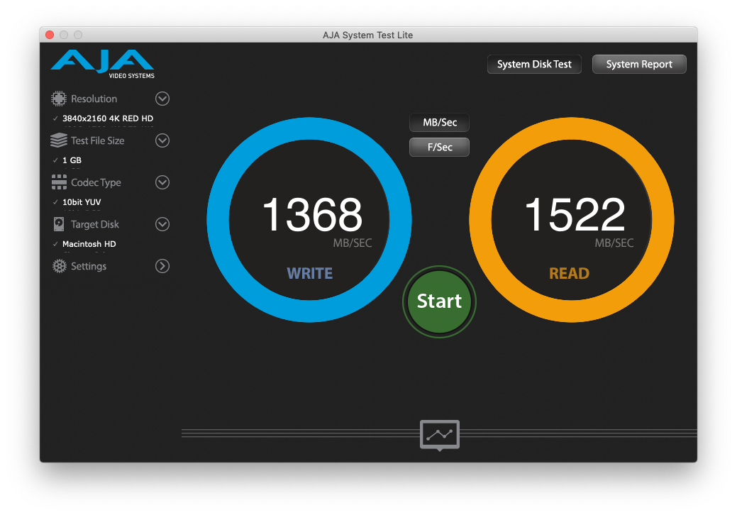

I upgraded my nMP to a 12-core Xeon that I bought from eBay (I think the reseller was Sun Microsystems) and an OWC Aura Pro X2 1TB SSD. In single-core performance the 12-core drags ass but in multi-core (where I personally need the performance) it's fantastic. In day to day use I do not notice the slower single-core performance of my 12-core vs the 6-core that my system shipped with.
Also, the original Auto Pro SSDs got a bad rap but the newer versions pretty much saturate the PCIe bus. Here are the write/read speeds I'm seeing.
