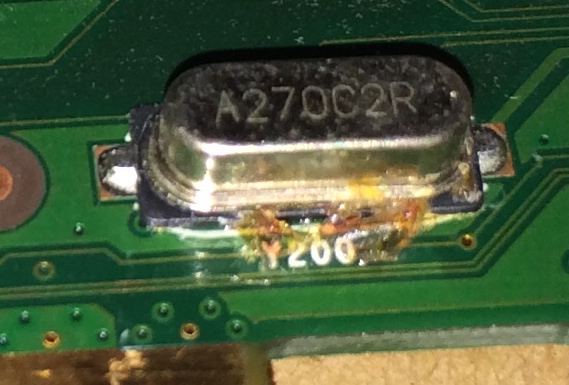

The GeForce was quite filthy in the fan, which seems to be an aftermarket IcebergQ4 and needs powering from a molex splitter as its plug does not fit into the power slot on the card itself. I have some hopes of reviving this card as it would be quite nice to have. There does appear to be some brownish residue below the silver (capacitor?) next to the power socket above the AGP notch.

That looks like cap leakage to me. I think that that cap is dead, but if anyone else knows otherwise just correct me.
Quite possibly but not fatal, yet. I cleaned up the fan on the GeForce and tried again. I got to O/F with some artefacts on the right of the screen and the fan on the GPU squawking then gradually slowing down. I switched off at this stage as this seemed to be a classic case of the fan not cooling the gpu adequately - both the noise and the artefacts.
I took off the fan and noticed that heat compound had been applied liberally and inexpertly. Unfortunately, whoever did it had not bothered to remove the previous compound/pad, which had hardened around the centre of the die and at the edges. It would not scrape off easily so I have ordered some isopropyl to remove it properly.
It may be that inadequate cooling has gradually led to a death of the capacitor but I am hopeful that it is nothing more than a flesh wound.

That looks like a clock generating chip, never seen one fail before
