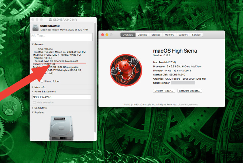

I’m using High Sierra 10.13.6 on a HFS+ Mac OS Extended Journaled SSD drive. It’s possible to run High Sierra under HFS+ From Sierra 10.12.6 I upgraded to High Sierra and retained the HFS+ format. I still need the HFS+ due to my daily work. I use Time Machine and DiskWarrior as these apps don’t work with APFS format. I think both formats are good and just depends on the needs of the user. They say APFS runs better on SSDs and HFS+ format is good with mechanical drives.
Here is an article on how to install High Sierra retaining the HFS+ format
Comparison Benchmarks between HFS+ and APFS

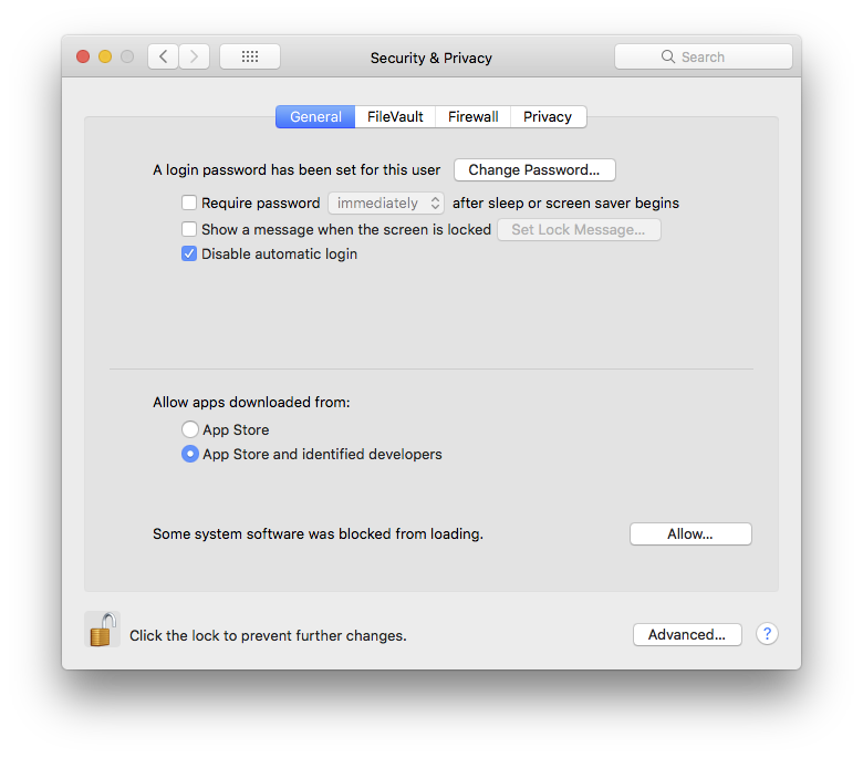

I no longer get any error messages when booting into 10.13 (I just tried) but if I go to the Security & Privacy system preference it looks like this:
If I click on the "Allow" button (next to "Some system software was blocked from loading") nothing happens, and it looks the same after rebooting.
I assume all those other apps which were blocked are still disabled (I took screenshots of these in another thread), but I have no idea what they're for.

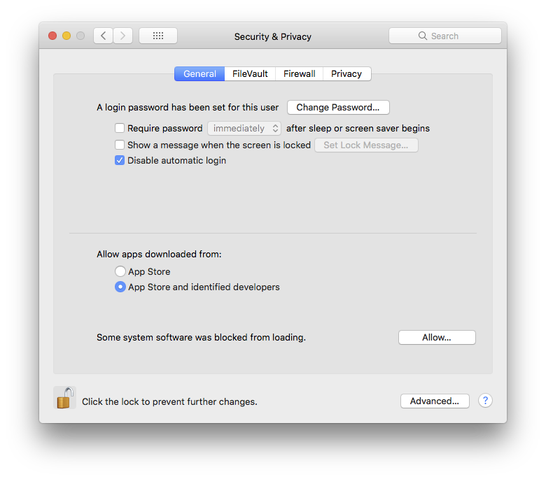

Found it, so I moved all its contents over to a new, empty folder on the desktop and rebooted. But the Security & Privacy system preferences still tells me that something is blocked (again, pressing the "Allow" button does nothing):
I also chose to uninstall Little Snitch, then install it again (which made a file named "LittleSnitch.kext" appear there).
