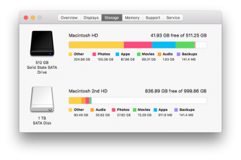

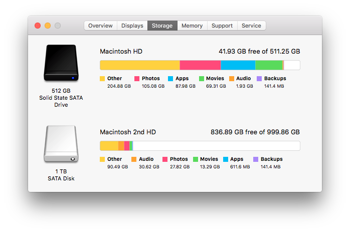

Hi,...
I have the same mac mini as you...
I replaced the HHD with SSD easily by following this video tutorial:
Took me about 20 minutes total. So I would totally advice you to do it! Boot time is now 8 seconds.
Startup of applications such as Photoshop takes 5 seconds.
I got the Crucial MX200 500GB. More than enough for me.
