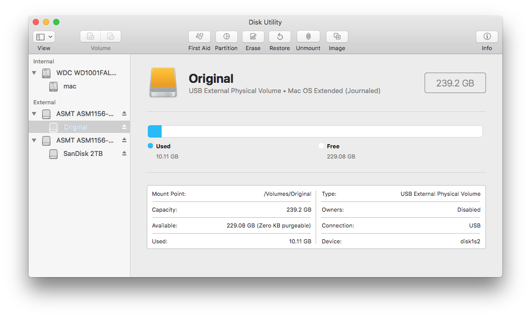

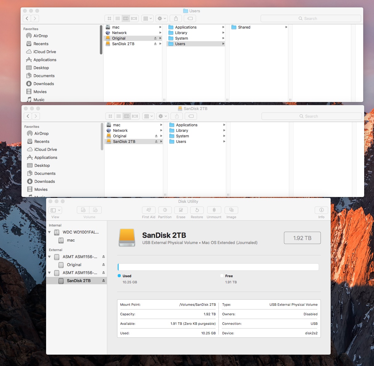

OK, I finally got around to taking a screenshot of the Finder for both drives
You're supposed to see the users when you view the Users directory. You may not be able to access all of the files in those user directories, but you're supposed to at least see that the user directories exist. Is that original drive damaged? Have you run First Aid on it?

Looking at the first pic you posted above, I see the drive "mac".
What happens if you click on THAT drive?
Does it have a users folder?
I removed the standard HDD from the 2011, which I had configured for four family users. When I looked at that drive, I can see our profile folders under the "Users" folder, so that tells me I should be seeing the same thing on the SSD from the 2009 machine, but they are not there. So I got a trial version of EaseUS to recover data and our user folders are all there, deleted. I don't understand how that happened because I took the 2009 iMac to an Apple Store and they told me that the logic board was bad. So if they couldn't even turn the machine on, I don't understand how they managed to delete all the user profiles. The only folder that remained was "Shared". I'll just have to chalk this one up as a mystery and shrug it off.

I agree -- something did happen, but it's a mystery. I'm thinking now that I might have blown everything away myself when I was trying to reboot the machine 20 different ways when the logic board started failing, before I had it diagnosed at the Apple Store. Unfortunately, there's no accessible user data on that original 240GB SSD drive. I can only see the deleted user folders when I scan the drive with EaseUS. I mentioned the user folders on the HDD from the "new" 2011 machine, because that just gave me confirmation that when you take out the drive from the machine and put it in a docking station on another machine, the individual user folders are visible in Finder when you open the "Users" folder.
