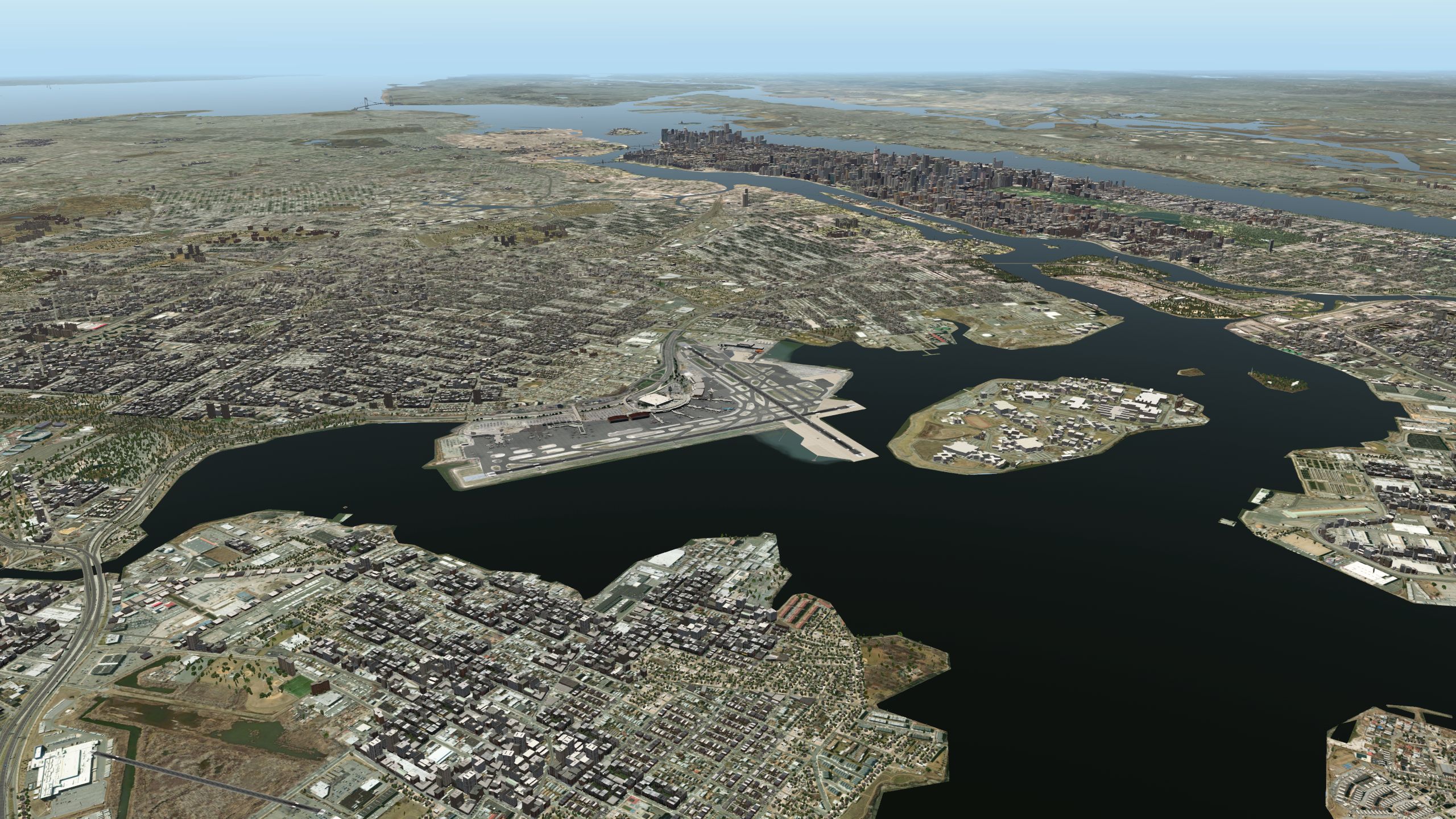

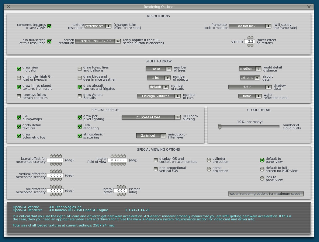

Attached are 2 sreenshots of X-Plane 10 running on my current system (Mac Pro '08, 8 x 2.8, 16 GB RAM, Radeon 7950, SSD boot)
One screenshot is the scenery of New York City loaded, the other are my grfx settings including the amount of VRAM consumed (it is now 2587 MB, i.e 2.5 GB) once NYC is loaded.

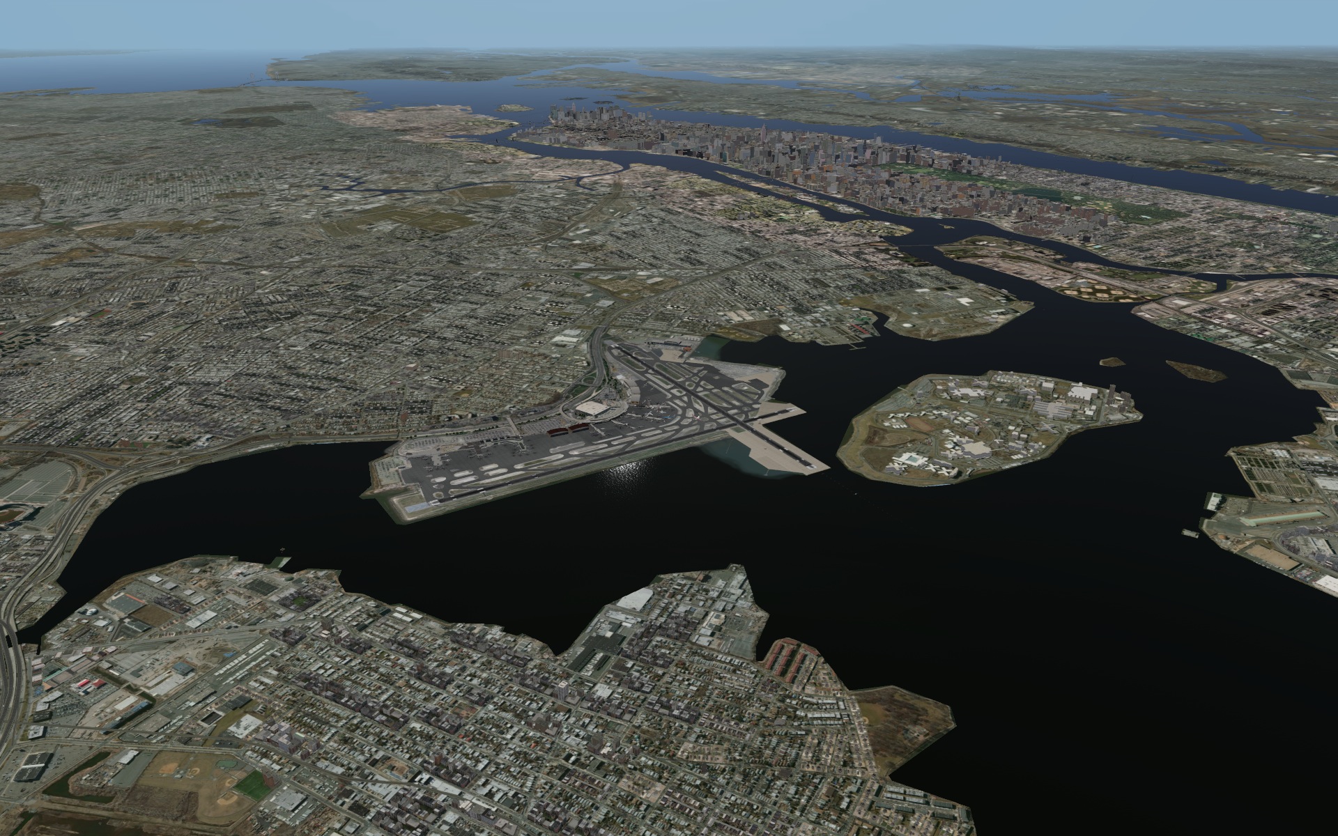

Settings comparison 7950 - 780M
In my earlier post I made a few screenshots on my Mac Pro with 7950.
Now attached similar screenshots made with my maxed out Haswell iMac.
Checkout the differences.
