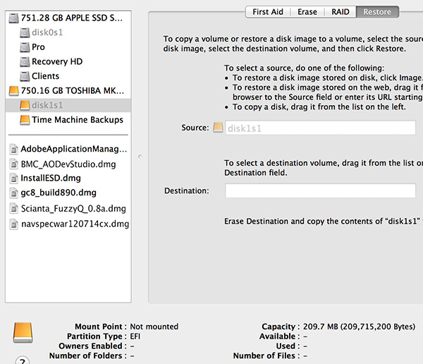

Never heard of the time machine disk being bootable. It contains no bootable OS.
No, but it does contain a recovery partition!!!

What do you suspect will occur if you boot a 2012 MBP from a Recovery Partition created on/by a 2010 MBP?
if it was created using Lion it will work fine. It just saves your files and settings...nothing hardware related. You can restore an older OS time machine to a new machine too...but I don't think you can boot from it.
Sounds like you're talking about Time Machine; what you quoted from me was specifically talking about Recovery Partition. As you undoubtedly know, they are very different things.
Correct on the first count for sure; I've done this myself. (SL to Lion)
Even if you could, I think it'd be risky (at best) to boot a newer computer from an image created by a previous generation. Definitely not something I'd risk given how simple it is to use Internet Recovery to ensure a bootable image suited to your hardware.
I dont understand how you would boot a machine off of another machines recovery partition....I guess if you used a 3rd party application for cloning the disk.

Not exactly. It contains an EFI partition with no OS installer.
Hey, I don't know. Possibly because you're wrong so much of the time. 🙂
wow, so clever. And yes, you can restore to a perfectly untouched drive from a time machine...I have done it, you are wrong.
Wrong about what? When did I suggest you couldn't restore to a "perfectly untouched drive"? I did say that a TimeMachine disk does not have a recovery partition on it. Which is correct.
