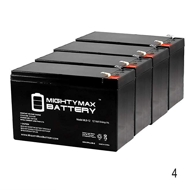

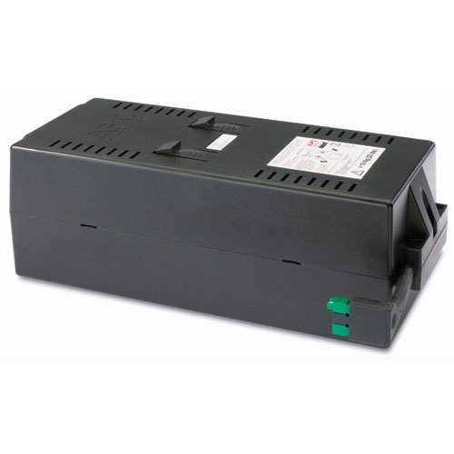

Also, depending on your model you can open the battery pack and just change out the batteries inside which are industry standard.
For example my APC's battery pack looks like this:
But when I open it up, inside are four common 12v 9ah sealed lead acid batteries like below. These run about $20 each at my local battery store (getting some credit for trading in the old ones):
