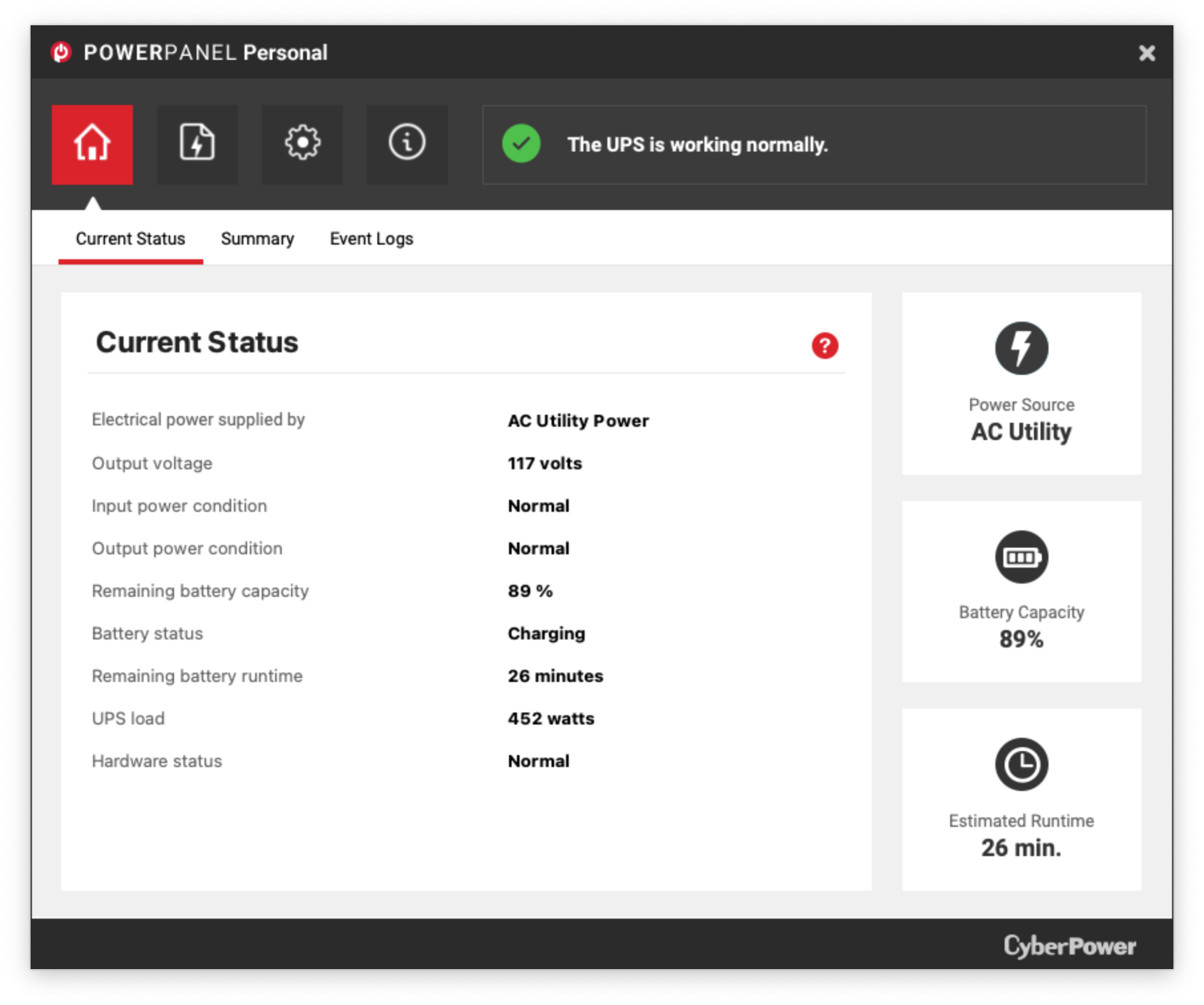

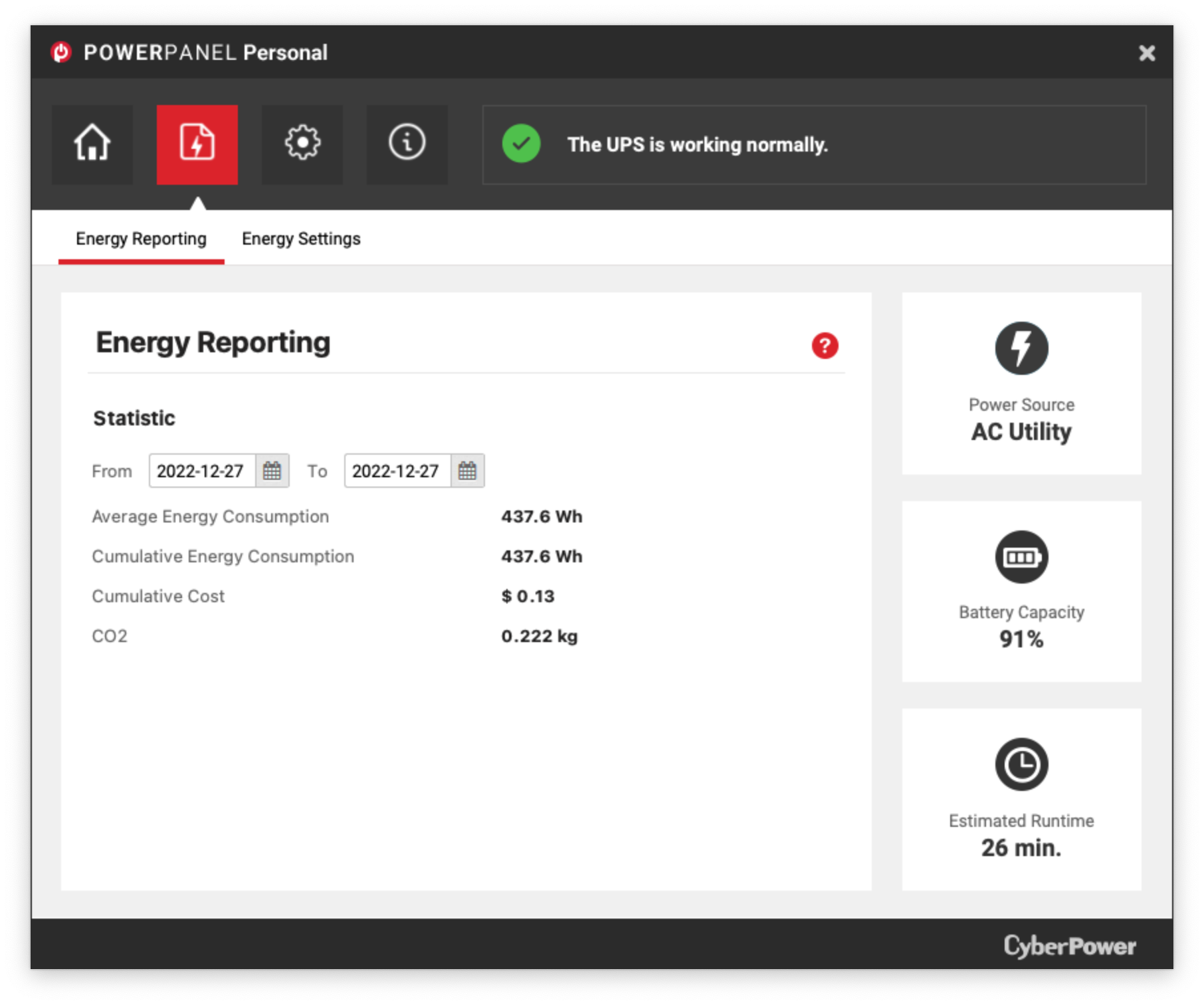

I have used a CyberPower PRL1500 LCD for years. Chose CyberPower due to their Mac App which can tell you such things as the cost of power you used this month.
You should test monthly and replace the batteries every 3 years or so. I wasn't testing but thought everything was OK. At the 5 year point when I ran a test, it failed, and the UPS stopped working. There is a different model series which will run if the batteries are dead. The battery swelled up and was a #$%$# to remove but now with the replacement it works fine. Learned my lesson and am testing monthly now.
