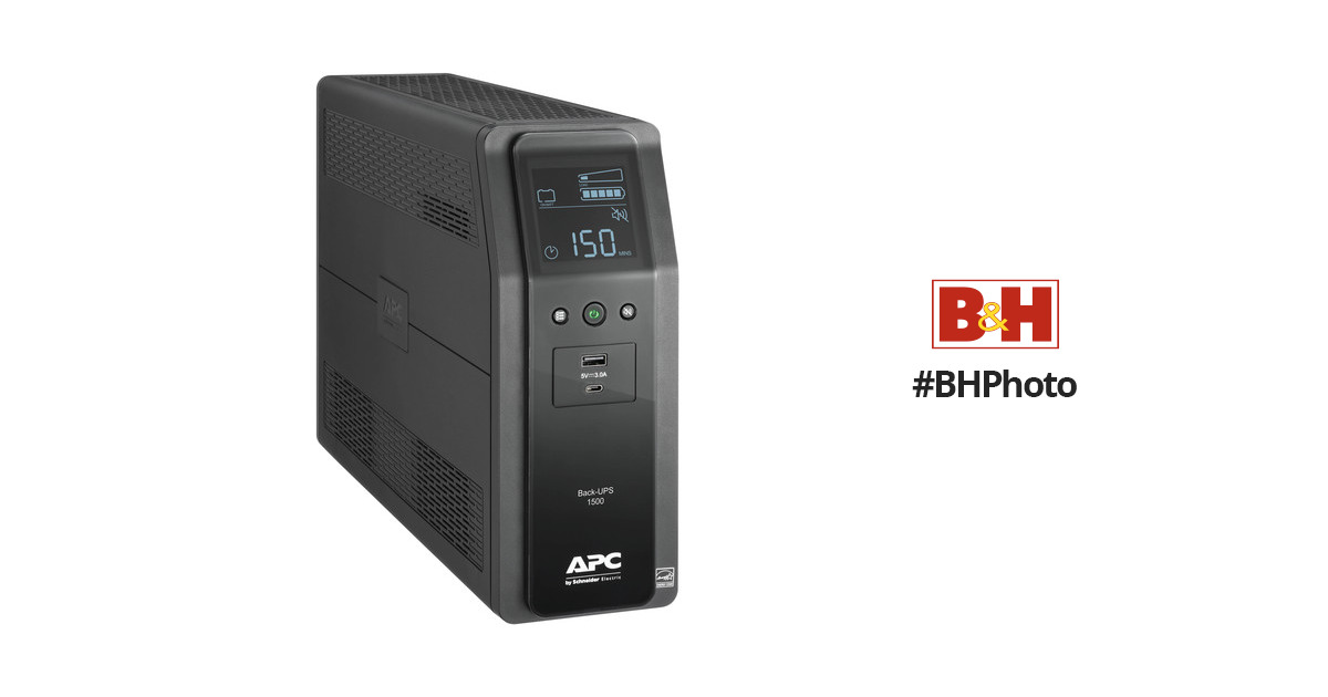

I just purchased one of these a few weeks ago to replace another APC 1500/900 unit that finally was acting erratic after a few years:
On my 12-Core, I have not seen it go above 250 watts draw yet.
