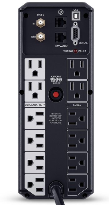

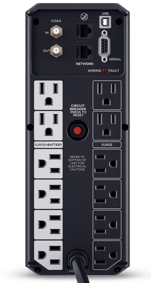

Have you tried connecting your iMac to a different socket on the UPS.
There is only 1 port on the usb that is available to me.

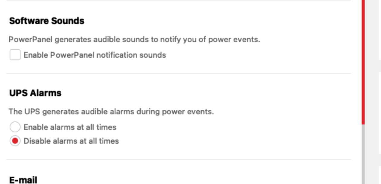

I'm assuming you have installed the latest version of the Cyberpower UPS management software for macOS, yes?
Open the management software and disable audible alarms... although, you are hearing the beep because there are power management events. You should review those events.
The alarms are coming from the imac,not the ups.
Looks like you have the PowerPanel audible notifications disabled (these would come from your Mac). Starting to smell like an application pref issue. Did you uninstall previous version of management software before installing latest, or did you install over top of previous version?
