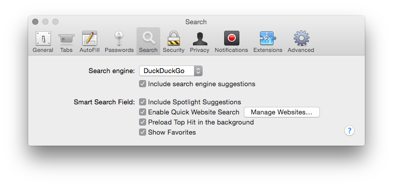

LOL... ok, I'll give DuckDuckGo a try. I usually use Bing as I find it just as accurate as Google and don't feel like I'm selling myself out by using it.
