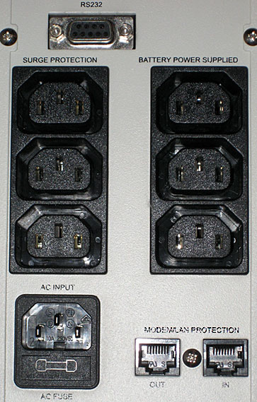

1. What kind of a UPS would you suggest for the 27" iMac?
2. Ive already got an older UPS Ablerex VT1000, is it still good enough for the iMac as far as specs are concerned or will i have to get a new one? Αny suggestion?
3. Is it lacking any new options that newer UPS offer? if so, what might those be?

what about what i already have, the Ablerex VT1000? is it still good enough for my 27" iMac? and if not why, where is it lacking?

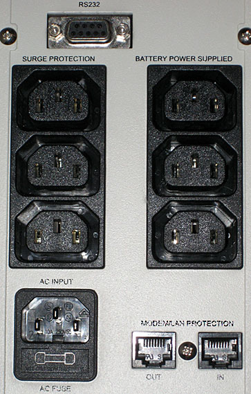

can anyone tell me if the port (RS232) that my Ablerex VT1000 gives can it be used like USB newer modles have?
"not easily" answer gives people hope... 😉 can you be more precise?
There are serial to USB interfaces that you can buy. They can be notoriously fussy with certain devices though so you take your chances. Not likely the Apple software will recognize your UPS connected this way. Possible but not likely.
In regards to your question on using your old UPS, yes you can and it is an appropriate size according to the label. I recommended getting a newer model on the basis of the technology is better now and you really need the UPS to communicate with the iMac so that it can handle shutdowns without intervention by you. Otherwise the battery backup will just finally run out of juice and the computer will shutdown even if you have files open. That leaves a risk of data corruption and/or data loss. Cheers!

i have no clue what type (line interactive, standby, online) of UPS is the one i have (Ablerex VT1000) and i also dont know if its ok nowadays to have sutch a UPS, what do i loose if its an older outfashioned model?
Sorry Zoran, I really don't know the specs of your UPS either as I'm not familiar with that brand at all.
You lose the automated shutdown as mentioned previously and it's highly unlikely that your old UPS does any effective power conditioning. It's obviously your call if you want to use it and it will work for the purposes of providing a basic battery backup but it's really only half a solution if the UPS is not talking to the computer.
That SMT1000i that Daniel recommended looks like a good choice for you and offers AVR (automatic voltage regulation) so it is conditioning the power as well. At 635 watts it has slightly more capacity than your old unit and is appropriately sized for your 27" iMac.
James
