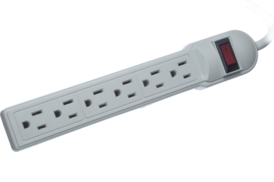

I see something else that doesn't match. How are you connecting 9 iMacs to a UPS that has 4 powered outlets?
I have used a surge protector that allows me to connect multiple devices
UPS and protector manufacturers quietly recommend no protector connected to a UPS. Because power from a UPS in battery backup mode is so dirty.
Since robust, that dirty UPS power is not harmful to any electronics. But can be harmful to a protector. That protector, in turn, might be harmful to the UPS. Better is a power strip with an always required 15 amp circuit breaker and no protector parts.
A UPS is often made so cheaply as to even require a new battery every three years. Generally, 9 150 watt electronic loads would need maybe 1.9k watts as that UPS ages and for other technical reasons.

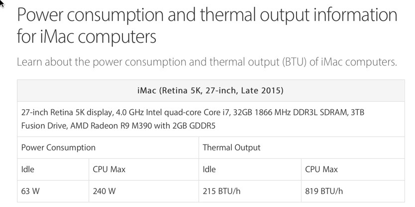

To the OP....here is some good information about the iMac power consumption.....direct from the horses mouth, Apple.
