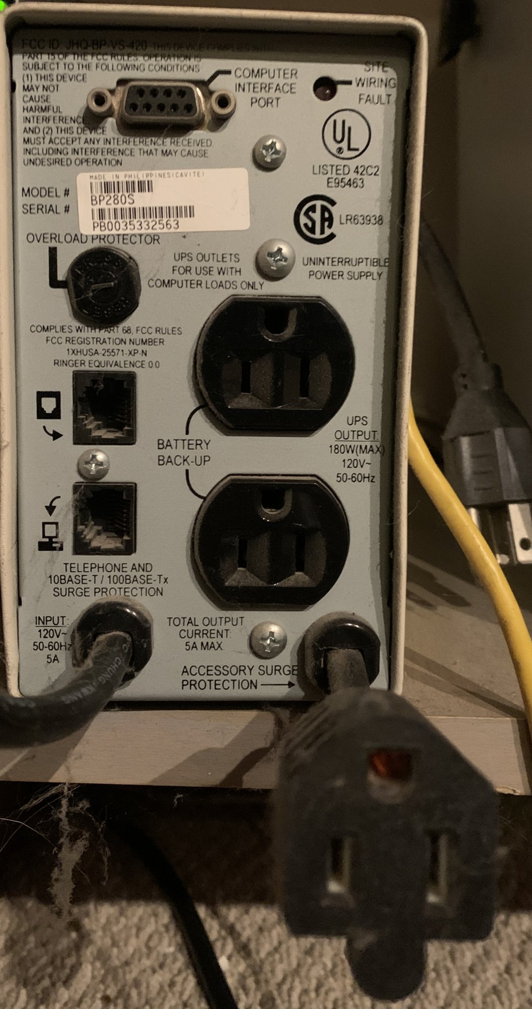

I have an older APC UPS (APC Back-UPS Pro 280) and expect for occasionally needing a new battery it works great.
Do I need a surge protector too?
If so, before or after the UPS.
I originally thought I didn’t. The UPS would protect my desktop from any surges but now I’m having some doubts

Why are you having doubts?
Saw someone else’s newer APC UPS and it mentions “surge protection” all over the packaging and it made me wonder about my older unit that doesn’t have any of that marketing on the unit.
It should be clearly marked on the back of the unit which outlets are surge protection only and which are battery backup + surge protection.
Reactions: Chuckeee
Hence my ambiguity
Ideally, you should have surge protection built into your UPS. I would spend the money and get a newer UPS. What you have is ancient. If you get a surge as is, you could end up in bad shape with your electronics.
Most UPS surge protectors are good enough. If you have very expensive equipment, you should consider either adding a decently expensive power conditioner with voltage regulation (~1K) or get a better UPS.
