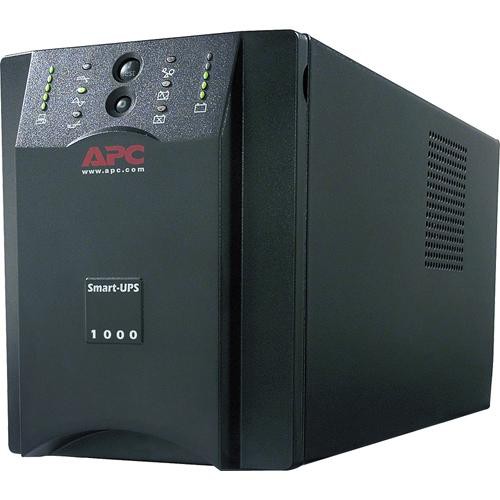

i use the this one...no silent beep button
but works well with my iMac and other powered Mac accessories (external speakers, extra monitors etc)
can shut down my iMac via Energy Saving setting on your preferred set times using supplied USB cable

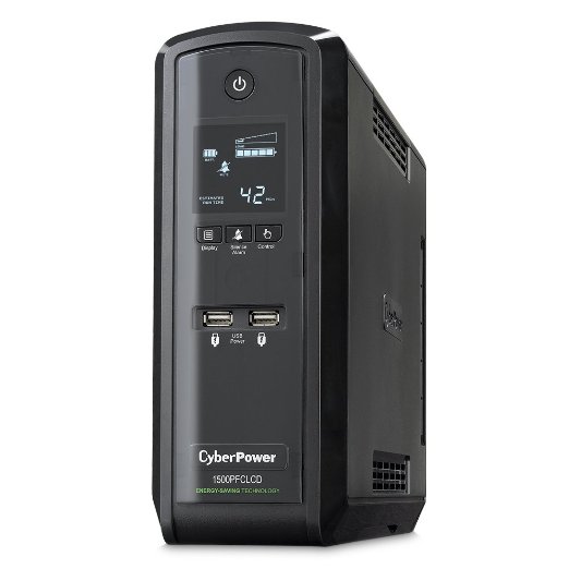

I received my Cyberpower 1500 unit.....
Boy this thing is pretty sweet, I like all the features and feedback, just wish it had software support for the Apple world.
I'm happy with my choice of getting a pure sine wave unit.......maybe not necessary for my iMac but it is for my security cameras.
