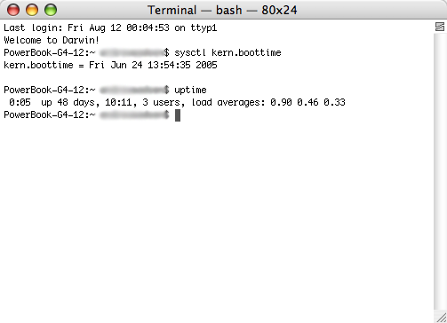

Has anybody seen this problem before? My uptime shows 40 days and 5 hours right now, but I know that my Mac hasn't been up that long. I don't know for sure when I last rebooted it, but it can't be longer ago than July 12, because that's when 10.4.2 was released, and I have that installed. That was only 29 days ago. uptime reported 38 days and some odd hours when I woke up this morning (about 15 hours ago), now it says 40 days, and 5 hours. My system clock is correct, and I haven't reset it or anything. Just wondering if anyone else has seen this behavior and knows why it might be happening.

Okay, that's weird. The uptime and w commands get their value by comparing the boot time stored in the kernel against the current time.
Try the command sysctl kern.boottime and see what is returned. Does that date make any sense?

Hmm...it tells me that the kernel was booted at 13:54 on Jun 24. That would sound OK, except that I've definitely got 10.4.2 and AFAIK, that was released on July 12.
Yeah, the update was in July. At least on some of the machines here with 10.4.2, the kernel happens to be dated June 24. Is it possible that your system clock was messed up at boot time and the network clock update corrected it soon thereafter? Your logs may have already rolled over and destroyed the evidence, but it might be interesting to poke around and see if you can find a bogus boot time in console.log or some wierdo offset value from ntpd in system.log or its archives.

Well, the problem with this idea is that it's continuing to get ahead of itself, even though my system clock is correct every time I look at it (which is often). Earlier today uptime said 41 days, now it says 48 days, 10 hours, 11 minutes!

The 48 and some days makes sense for that boot date, which hasn't changed from your last post. Did you check those logs for unusual times?
