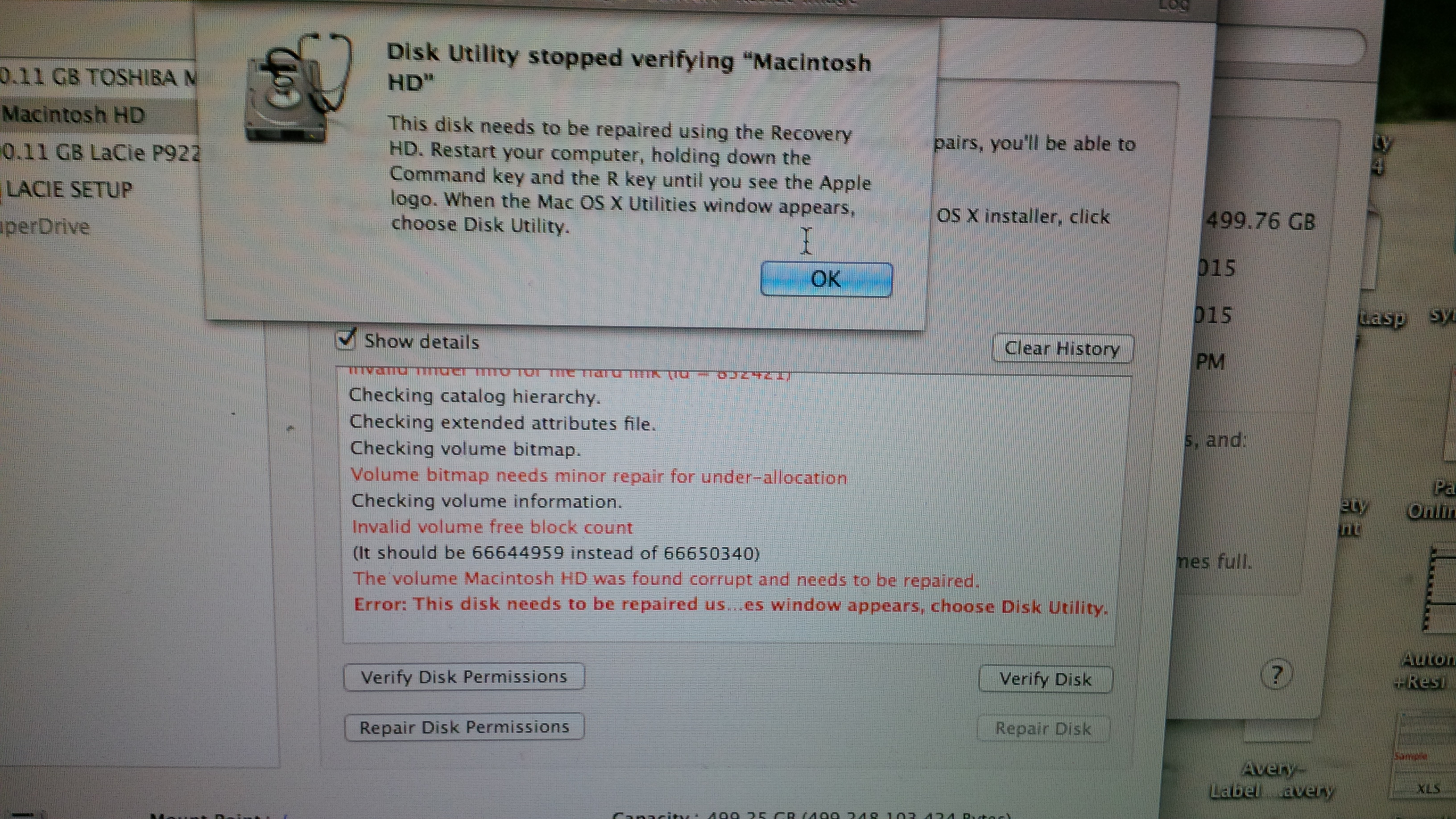

So long story short my Friends father has this 2012 macbook Pro model identifier 9,1 and it has been beach balling, crashing freezing lagging all the time. Its running OSX lion. We had it taken to the apple store and running apple diagnostics test and found that the OS had some corruption. The technician recommended a format reload and then the backup was taken from the time machine backup. That was on monday. It worked fine for a bit and then began to beach ball freeze and refuse to save word documents asking them to be renamed.

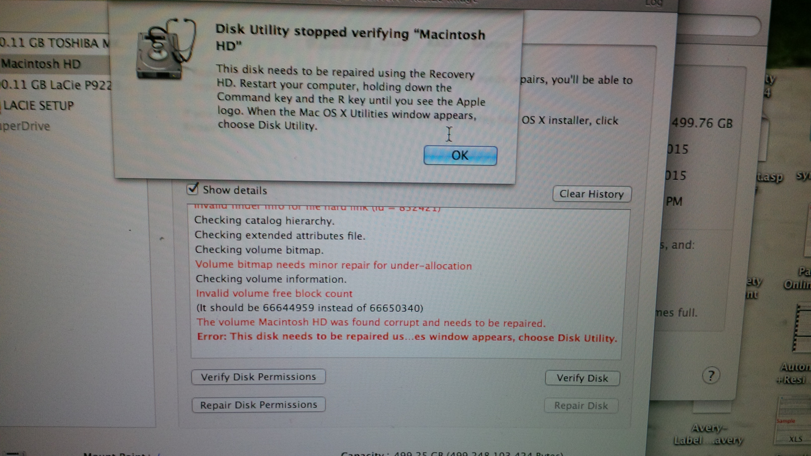

I ran a disk utility hard drive check on it and it gave me the errors in the photo. Then we ran another one today and everything appears to be fine. THis machine has applecare on it and although the technicians say the drive was fine, i fear it may be slowly on its way out. What do you think? should we go back and ask for a new drive?
Thanks let me know. WE need this machine bac up and running ASAP. All help is appreciated.

But would you agree that this is a possibly hard drive failure? i was working on a document again and when trying to save it gives me an error saying its being used by another program and needs to be renamed.

I would say the drive is bad. Either that, or the cable is going bad.

Bad news, sounds like your drive is on the way out. As crummy as it is, it happens - hard drives have moving parts that make them vulnerable.
For Apple, standard practice is to try a reinstall if your having issues like that - by doing a reinstall it helps them eliminate a software based software bug as a possible cause. If you haven't done it yet, then they are going to pester you at the Apple Store until you do. If it still happens after a reinstall then the next step they will take is replacing the hard drive with a new one.
There's an entire diagnostic process that needs to be done here. Could be the drive, could be the cable (paper thin and prone to failure) or could be the logic board connector. If it's the later two, another drive (SSD or otherwise) won't help. Remove the drive from the machine and boot with it in an external enclosure or dock would be the first elimination step... If you can, run drive diagnostic software against the drive when not booted to it (e.g. Disk Warrior). Apple Store should do this (before or after a clean install, if issues persist).

One thing I am noticing is that, in all of these attempts, you have done a TimeMachine restore each time and that your problems begin to manifest after doing that. Generally, restoring any full system backup when there was known data corruption is a big no no. It is very possible that there is corrupted data in your TimeMachine backup that when restored will just cause the same problems to come back. Even possibly a kext or driver that causes the drive or SATA controller to misbehave. Maybe even damage the new drive.
I would wipe the drive and install a clean copy of whichever OS version you prefer. Then, instead of a TimeMachine restore (which brings over system and application files), use Migration Assistant to bring over only your documents and data from the TimeMachine backup. Then install fresh copies of your Applications.
This eliminates the possibility of restoring a corrupt system or application file that could be the cause of all your troubles. And, if the problem does come back after the clean install, at least you will know it is a hardware problem at that point.
When I worked the Genius Bar it was standard operating procedure that you never restored a running copy of a possibly corrupt system to a repaired computer. This approach should definitely be tried on your machine before anyone else spends more time chasing a hardware problem that might not exist.

Replacing hard drive every time there is error is premature and unlikely to be done by Apple. I had hard drive errors pop up on me many times (across many systems I have). The worst offenders is SSD drive in my rMBP - until latest Yosemite installation, which I did clean install. SInce then, it has been rock solid. Go figure...
You need to boot in recovery partition (hold cmd-r immediately after you push power button) and run Diskutility from there, it can then fix the errors. If this fixes it and errors do not show (within reasonable time of may be few weeks), you are OK. If the errors show soon again, you have still problem, may be drive, may be cable, may be logic board. That is for Apple to solve. But drive with errors is common problem. Typical source (but there are many) is not orderly shut down, for example.

Yes. The difference between doing a restore from Time Machine and using Migration Assistant is that the restore literally restores a snapshot of your entire system. Migration assistant leaves the OS alone and only moves user documents and files. The Genius Bar should be able to assist you with Migration Assistant if you need it.

IT was 100% the drive as the system would freeze files refused to save etc. With the new drive im still getting errors in Disk utility both in Lion and recovery mode but nothings crashing or freezing anymore. The owner of the laptop is still worried about the errors showing up so come the weekend instead of doing a time machine restore i will be manually copying over his personal files installing mavericks then manually copying them back over.
Ive had my share of false errors, but when the machine is constantly freezing when the hard drive was working locking up then i have suspicion it was the drive. We believe that because he is using the same install it still shows drive errors. we want to get the hell off of 10.7 and start fresh
