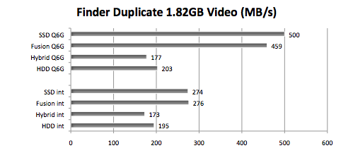

As time passed, the early reports were confirmed with graphical evidence like this chart from a set published by Bare Feats.
http://barefeats.com/hard176.html
Nope, "supposed to be" is the gateway to misinformation on that topic. Although the marketing hype would have us believe otherwise, the commonly available Hybrid Drives are nothing like an SSD in operation. Instead they are mostly like a HDD. The Fusion Drive on the other hand, is nothing like a regular HDD and similar to an SSD. Although an SSD will often outperform the Fusion Drive, the difference is small and often undetectable.

Yes, I agree. In Windows, a Momentus or similar device is as close as the OP will get to the Fusion Drive. My comment was intended to dispel the notion that he would actually be close to the FD experience. Those commercially available hybrid drives are merely high-performance hard disk drives.
Once separated from OS X or each other, the components of a Fusion Drive will not be able to approach the performance they delivered as automated tiered storage. We seem to agree.
