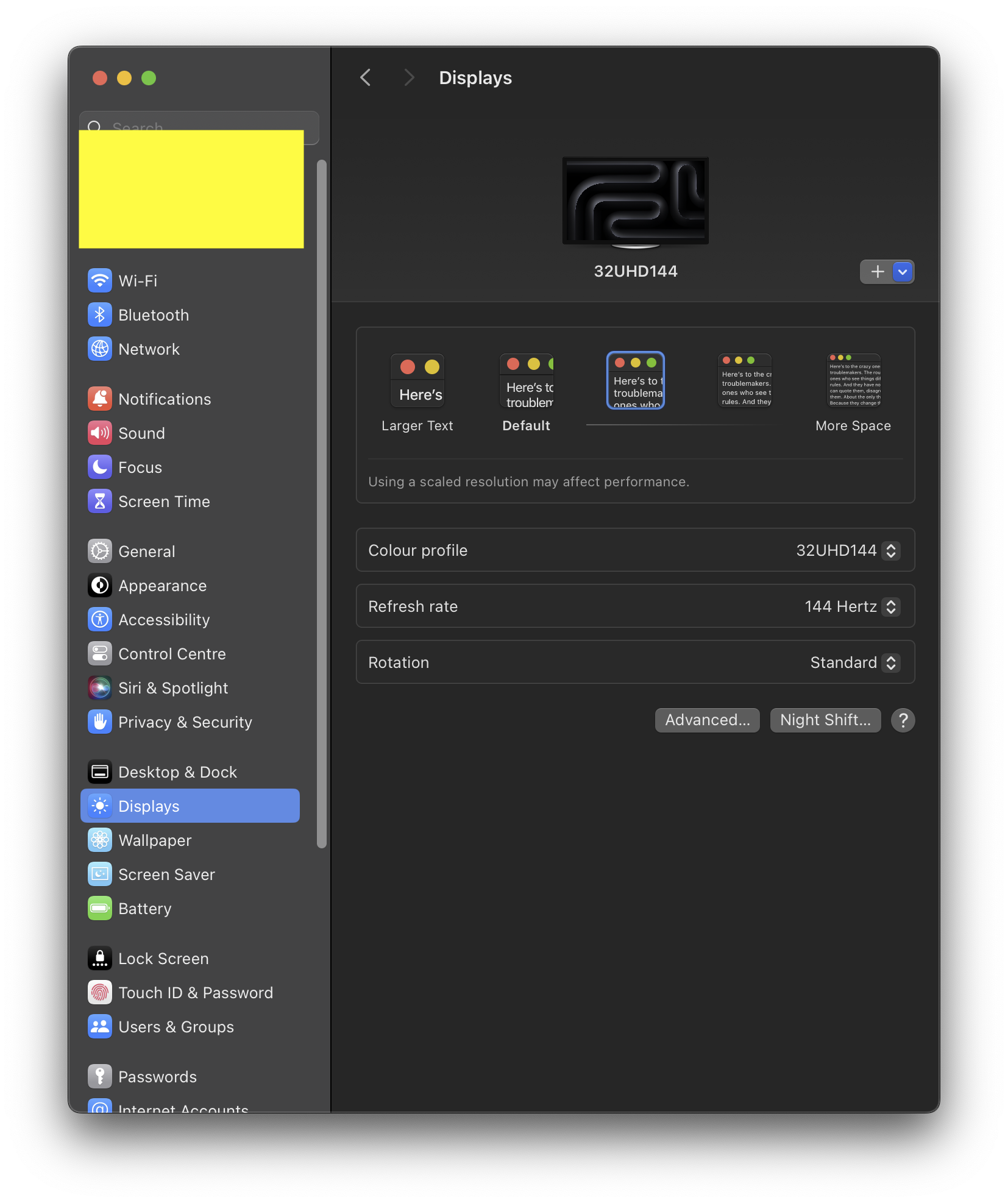

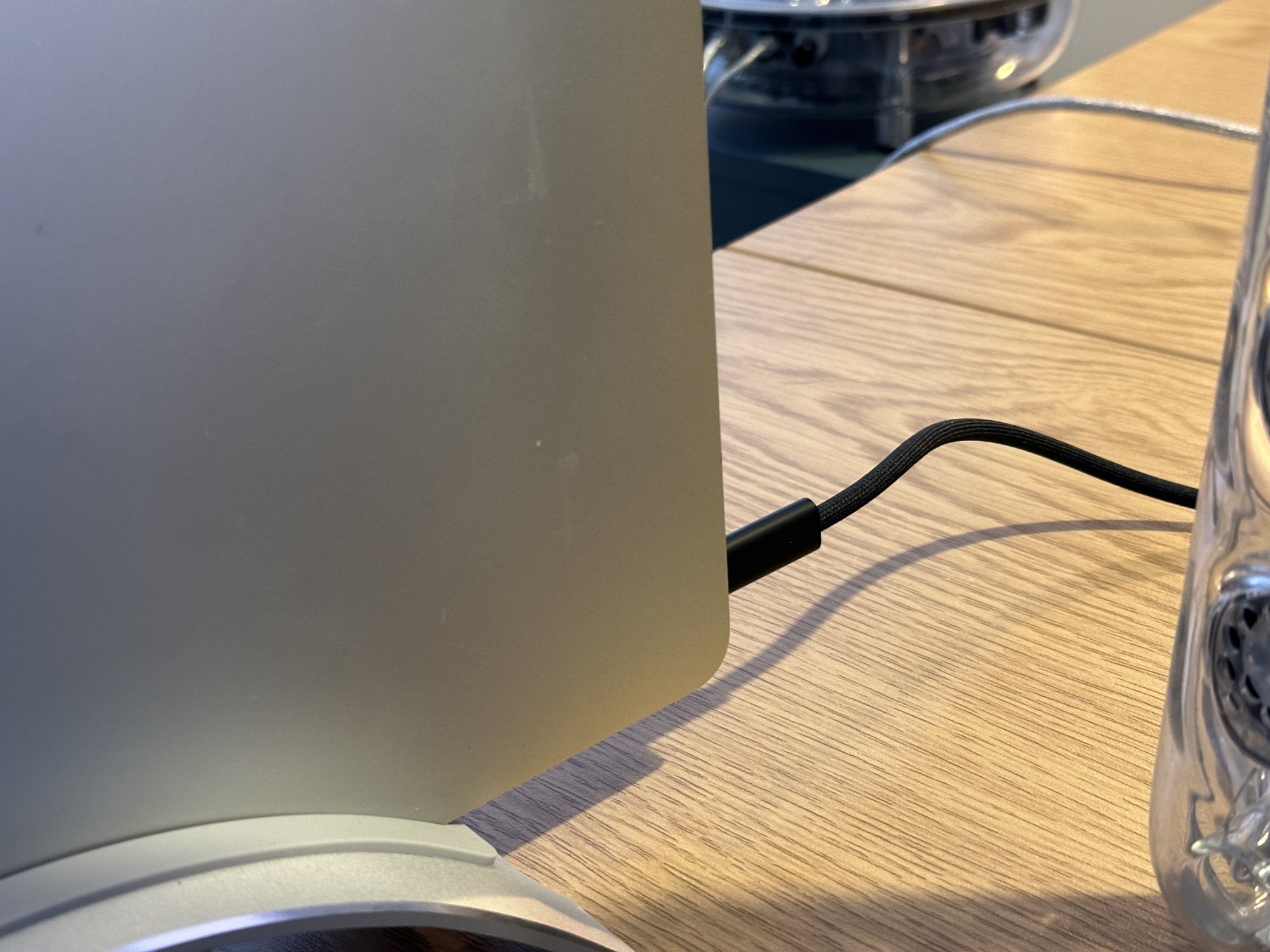

If the Samsung USB-C port has DP Alt Mode (ie, you can actually use it as the display cable for that monitor), then the Apple one will 100% work. I'm using it right now - here's the cable plugged into my M1 MBA, and here's the display settings showing how the monitor is working. This cable is designed for connecting Apple Silicon Macs to the Apple Studio Display, so I presume the tech specs on it are pretty high.

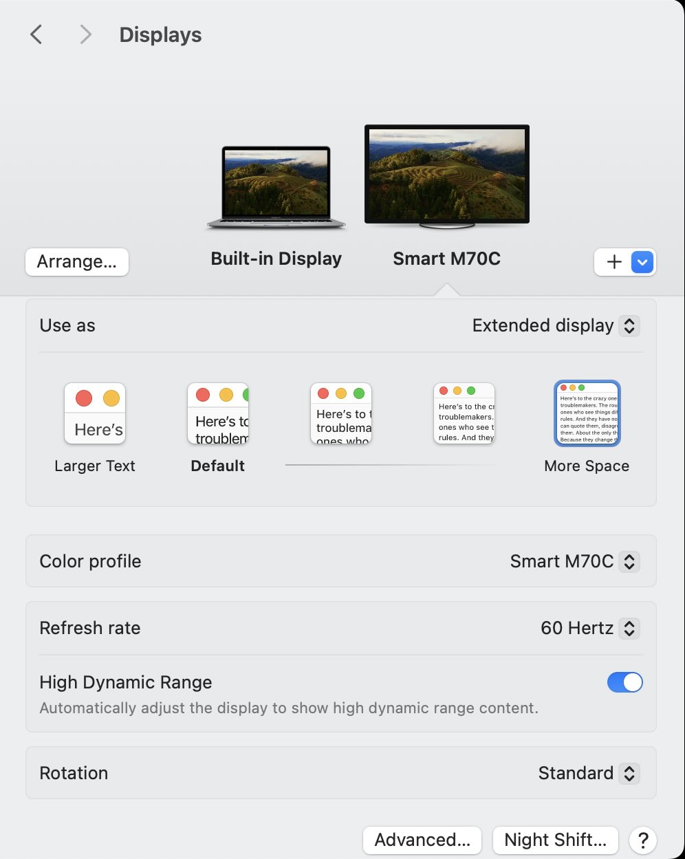

Good news. Adapter arrives and works really well.
