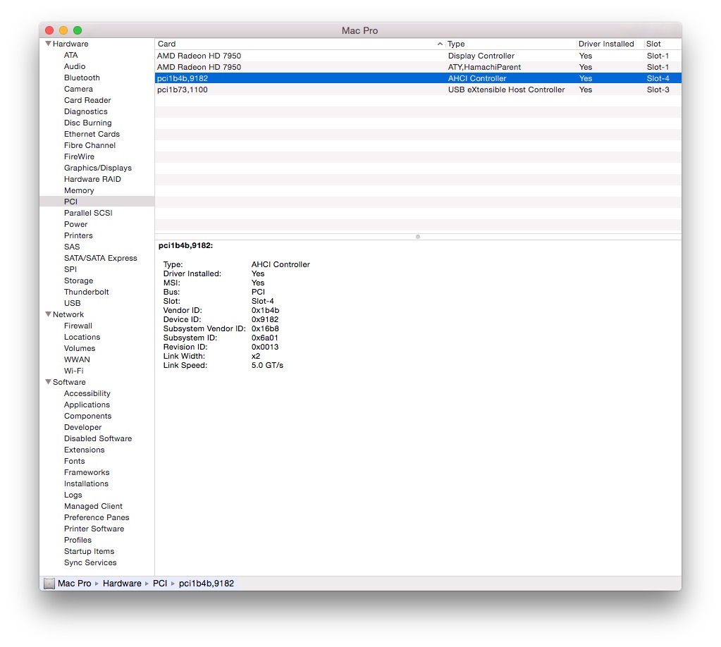

You have the Pro card. There are 2 chips on the card, that's why there are 2 separate AHCI controller on the same slot.
My card is the non Pro version, so only one controller shows up in the system profile.
