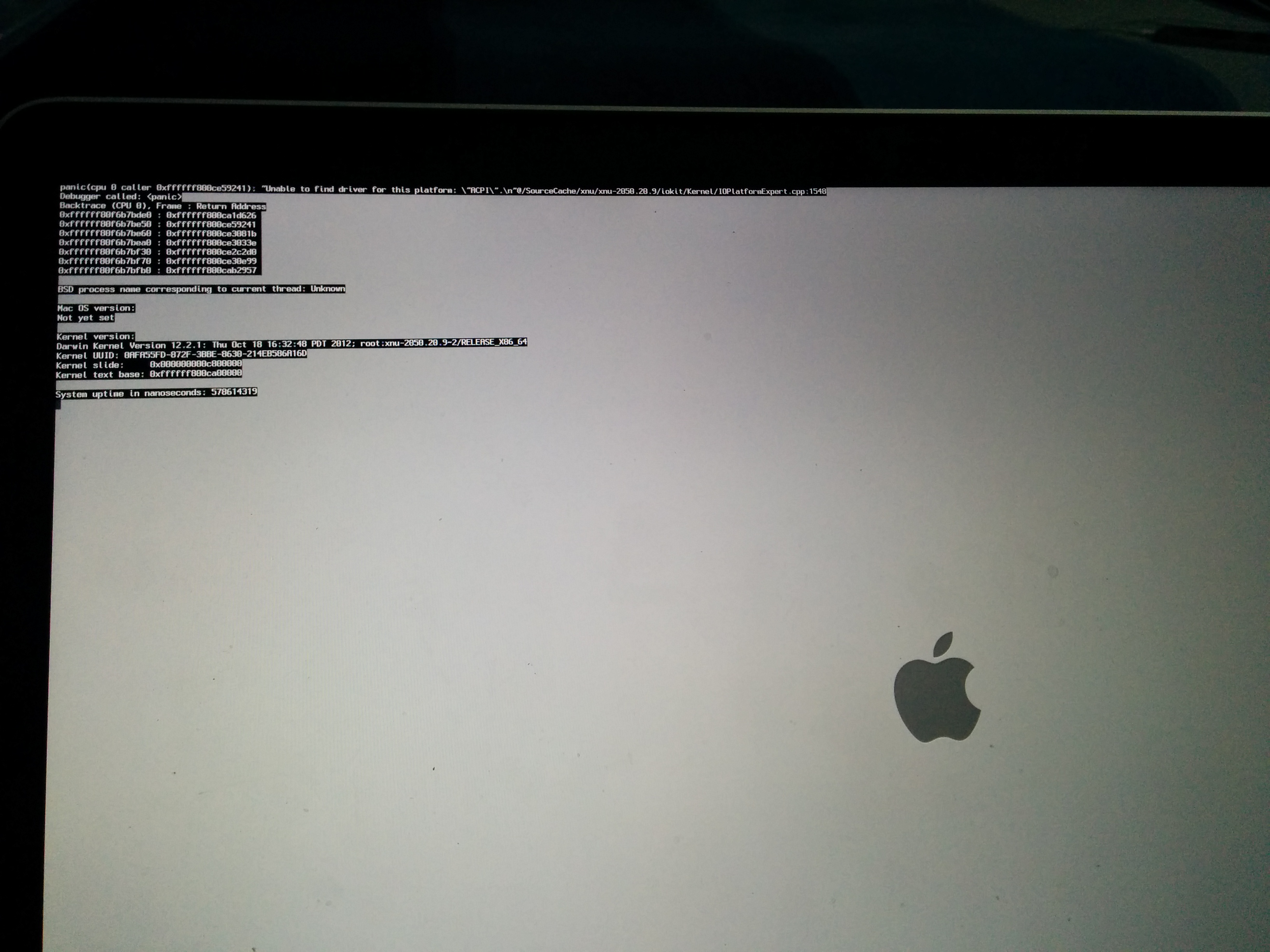

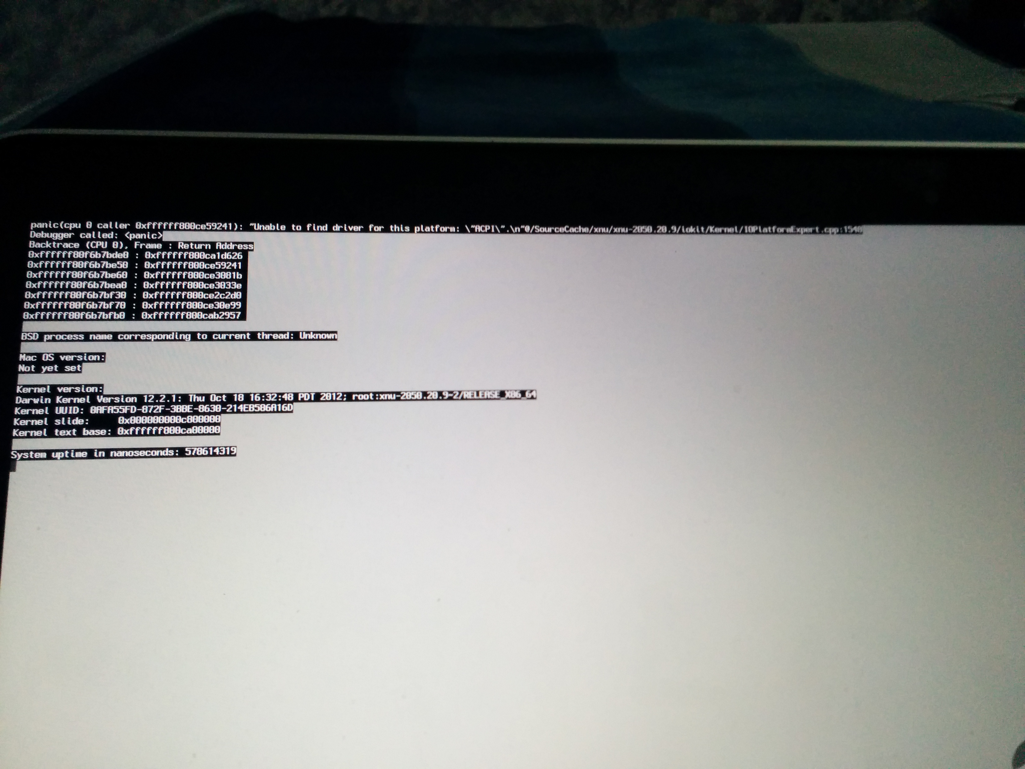

I was using my father's mid-2012 base model 15" rMBP to set up his iPhone. iTunes required a software update so I went ahead and updated everything, i.e. iTunes, iLife software, OS X 10.8.5, etc. (the rMBP was still on Mountain Lion). After rebooting to install the OS X bundle update and finishing the update process, I got an error saying that there was an unforseen error in updating and nothing was installed. After that, I had to hold the power button to switch the laptop off. Now, whenever I boot, I get the error attached in the screenshot on the Apple logo screen.
Please help. I'm at my wits end and want to avoid an OS reinstall at all costs.

Okay, so out of the frying pan and into the fire. I reinstalled Mountain Lion. Now, I'm getting a kernel panic on boot. So I'm stuck in a "Your computer was restarted because of a problem" loop. Any help?
Raptor
UPDATE: I did a PRAM reset. Now I'm stuck in a boot loop without the kernel panic screen.

Okay, still there. Single user mode is working.
What can I do to fix this kernel panic bootloop?
UPDATE: Verbose mode crashes again.
