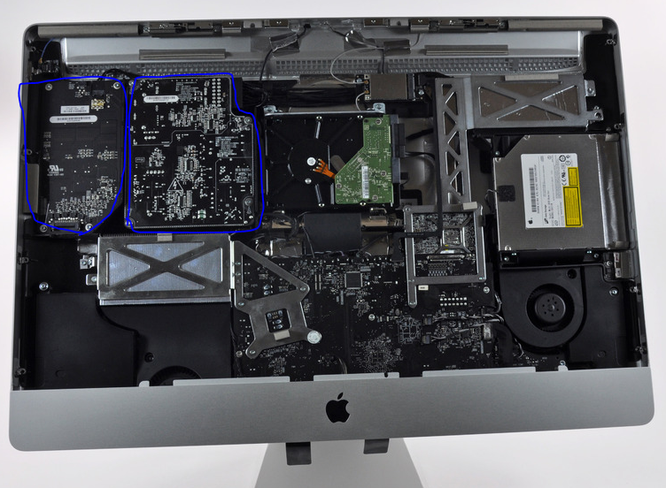

I circled them in blue. The one on the left is the inverter board, the one on the right is the PSU.
Indeed, it checks out with the apparent source of noise...the whine seems to increase with a mix of:

Is this just something that happens normally or should I take it to an AASP?
I would have it checked out by someone if you are not comfortable doing the work yourself (if I recall, you said it's out of warranty). I know, from experience, in the PC world when a PSU takes a dump it can claim a few items with it. It would be a shame to have it go out and take out the logic board of a GPU or screen or something.
I think a PSU can be sourced for around $100. Not sure what an AASP would charge for this sort of repair though.
Good luck and I hope you get the problem sorted out!
