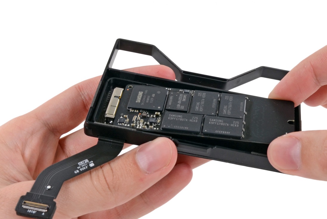

Late 2012 13" Retina means there is no sata3 interface with a separate cable for the power and sata cable. The MBP uses an ssd in a caddy which looks like an msata interface.
https://www.ifixit.com/Guide/MacBook+Pro+13-Inch+Retina+Display+Late+2012+SSD+Tray+Replacement/12822

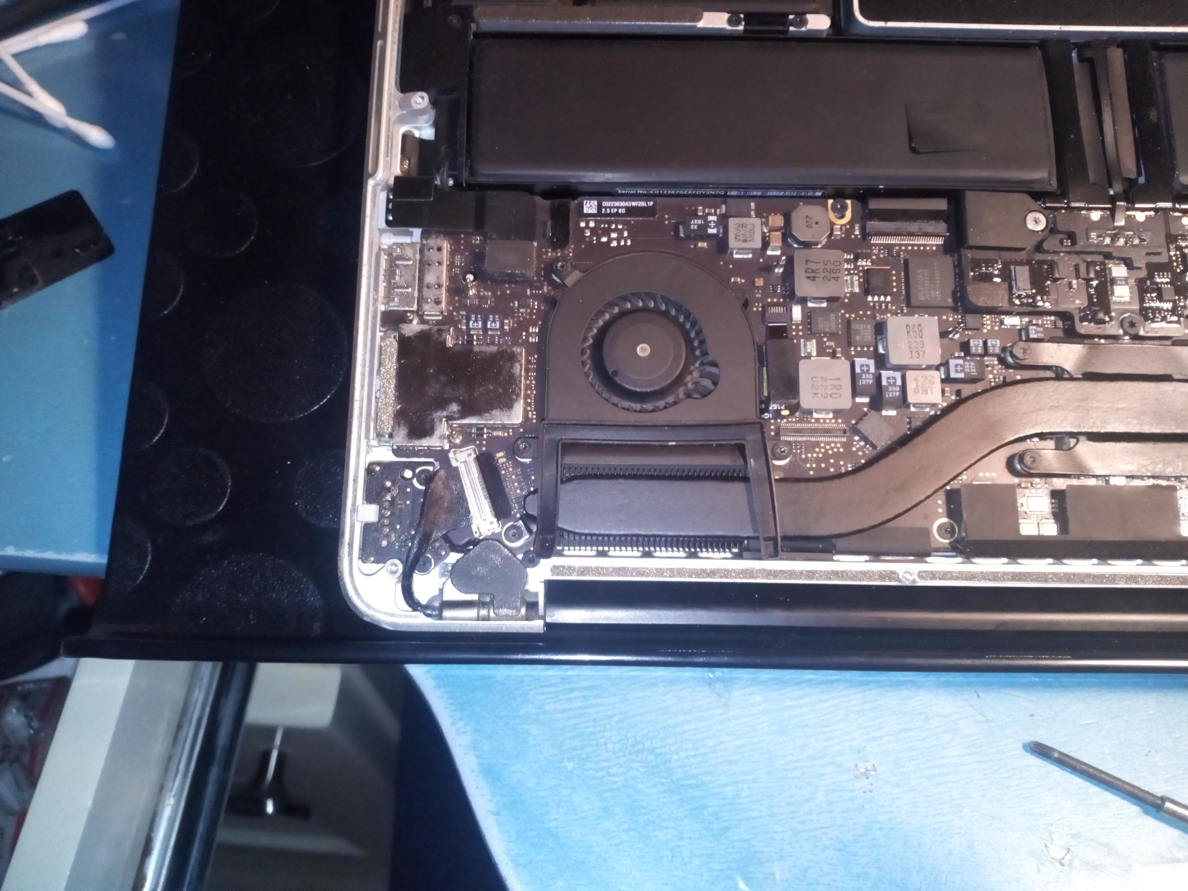

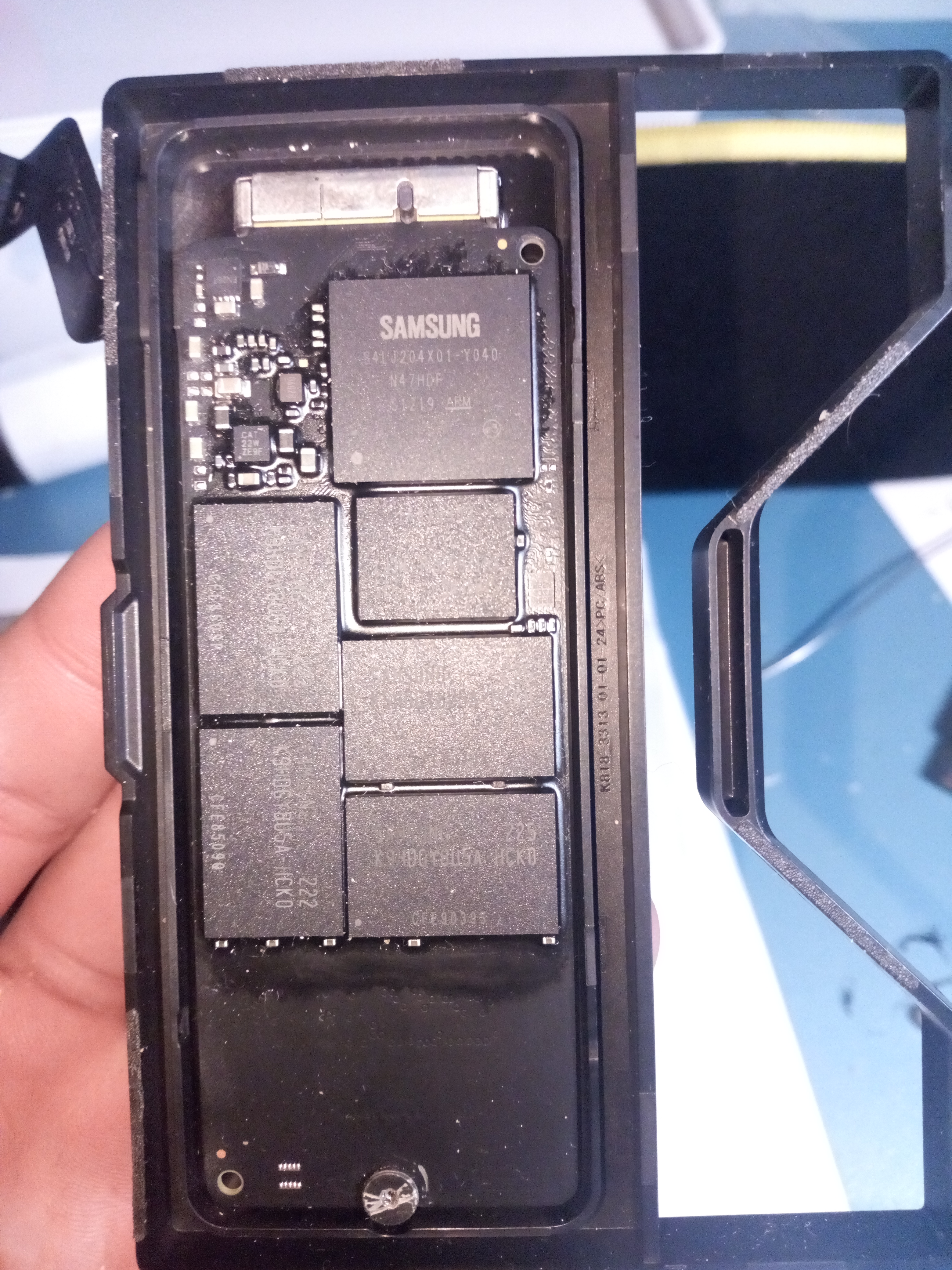

I opened it today, and it waswquite dusty, i wiped the dust off however it didn't seem to work here are some pictures
of the inside. Thanks for your helph
