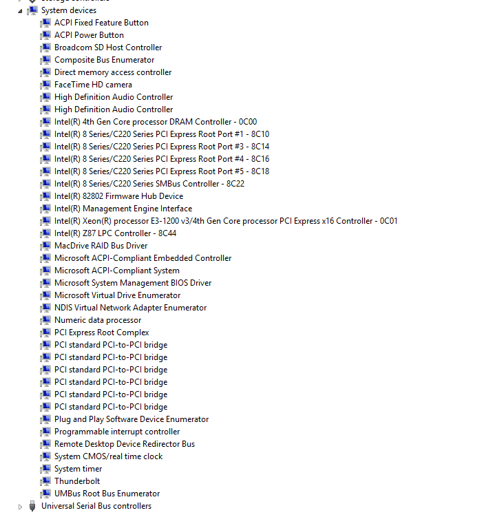

Hello guys, anyone with iMac late 2013 can send me a screenshot of his device manager, specifically the System devices section ? I have a strong feeling that Bootcamp messed up things for me as see below :
Sorry but I don't have one of the latest models but I'm curious as to what you think is wrong? There are no yellow triangles with exclamation marks to say that a driver is not installed or not working.
It all looks good to me.

Yes but Bootcamp doesn't completely support Windows 8.1
I had to install the drivers myself by checking the Hardware ID and Compatibility ID in Device Manager.
I managed to make everything work fine except that the Sleep option is not there. I am sure that there is something messed up with the driver version.

Small Update :
The missing sleep feature is caused by Thunderbolt device connected to my PC.
The only way to bring back the sleep feature is to reboot with the no TB device attached.
That literally S*CKS
Please check out this article. Sleep is disabled in Windows 8 (and 7) while a Thunderbolt device is connected.
http://support.apple.com/kb/HT5219#28
