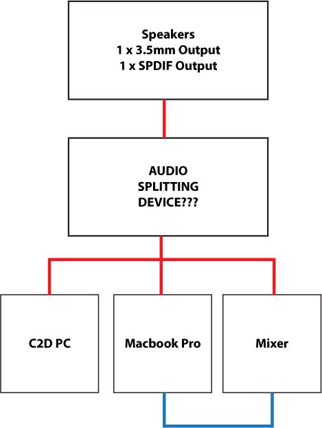

Hi
Ok. I think we have our wires crossed, but that doesn't matter - your reply has helped.
Here is a diagram of what I need it to look like (I think)
I think if I buy a phono switch box - then get some cables with phono at one end and 3.5in stereo jack on the other I can plug everything into the splitter and then the splitter plugs into the speakers.
Then I can switch between each input as I need it.
To record, I can get some another cable and run it out another OUTPUT port on the mixer and plug it into the Line In on the Mac. Won't matter if there is latency as I won't actually be hearing that record.
Sound do able?
beatzfreak
macrumors 6502
Jan 11, 2006
346
NYC
You should have a record out on your mixer, use that output to the mac and the main outs from the mixer to your speakers.
Though, you should probably still get some kind of usb sound card for the mac.
M-audio has some cheap ones that sound decent.

BlueJayLouchE
macrumors member
You shouldn't be using anything with the word phono on it... that's strictly for vinyl. no phono in. no phono out. no phono splitters. you want LINE. LINE level is what CD players, iPods, your laptop ect. output audio at.
Yes, your mixer should have REC out. If so plug that into the laptop and the Master, MSTR or Mix out into your amp/speakers.
This means as longs as your levels for each channel never hit red your recording won't clip. and you can control your speaker Vol. from the mixer without altering the lever going into the laptop. Oh and it removes the delay.
Hint. turn off monitoring in your audio recording software.
Peace.
EDIT: Avoid splitters like the plague. They F**K up your signal to noise ratio.
