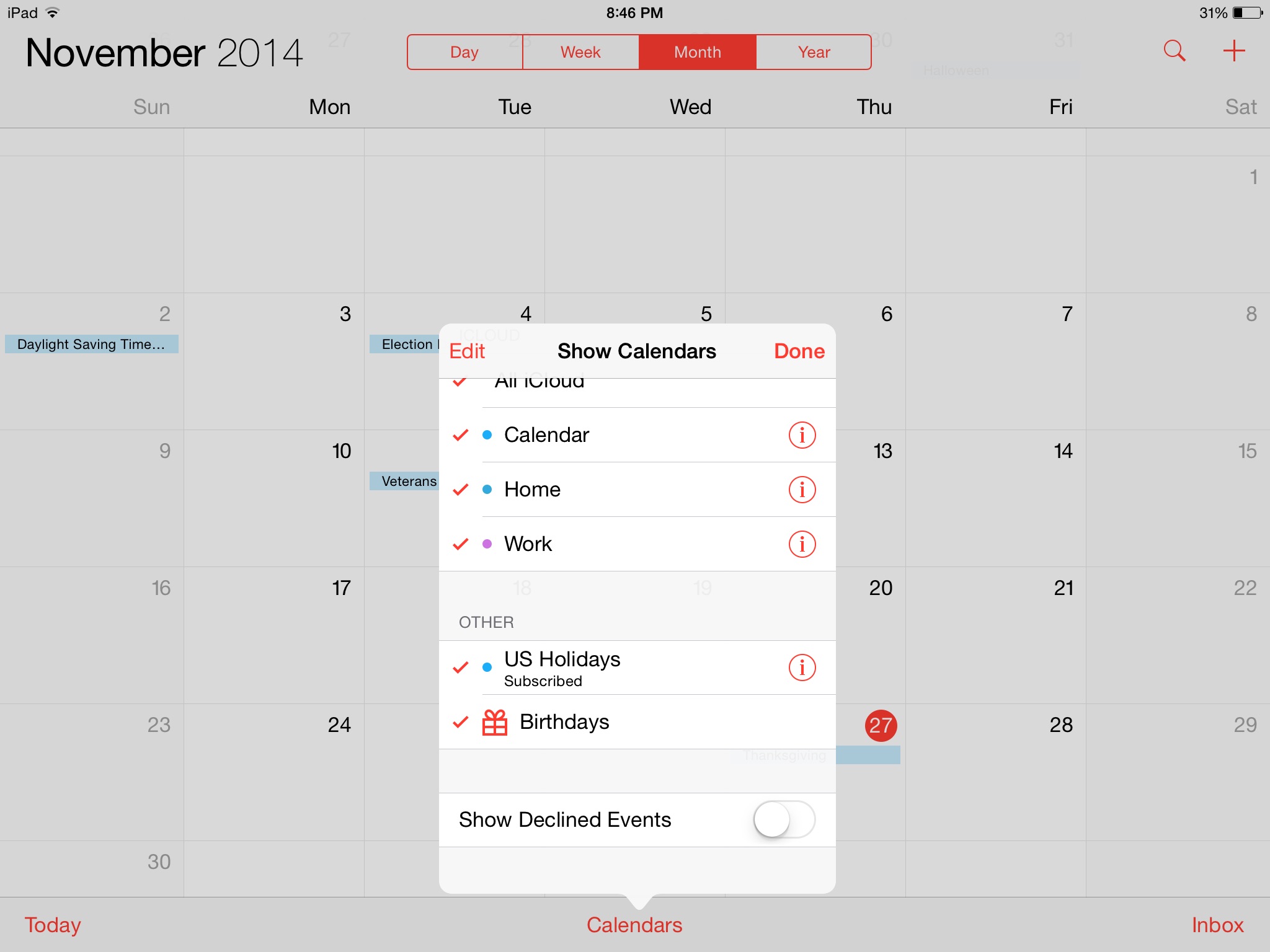

US Holidays is listed in Calendars under Other, it says Subscribed underneath it, and it is checked, but there are no holidays showing in the calendar.
I'm on an iPhone 6 running iOS 8.1.1

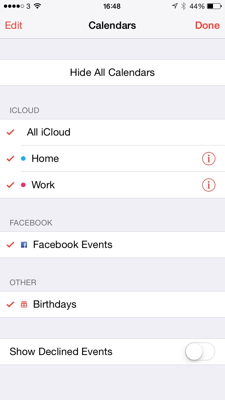

I have almost the same issue. I did a clean install to iOS 8.1.1 on iPhone 5s. The US holiday calendar used to be under "other" but now it disappeared. Pull down to refresh does not make it re-appear. Resetting the iPhone does not help either. Under mail, contact and calendar setting, there is still setting for Holiday calendar (fetch vs manual). That seems to suggest that Apple does not intentionally remove it from iOS. So I guess this is a bug either in iOS 8.1.1 or on Apple end.

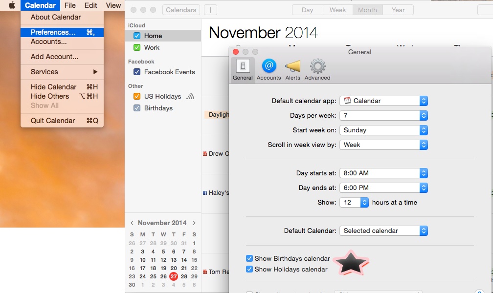

The holiday calendar works on OS X Yosemite without problem. I can check and uncheck the US holiday calendar in preference it disappear and shows up back as expected.

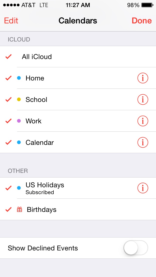

At the bottom of the calendar hit calendars and make sure this is checked.
Lucky, mine also dissapeared from my Mac after I try to uncheck it in preferences.
We don't have this option anymore, it is not even showing. That is the problem we try to describe. Are you on 8.1.1?

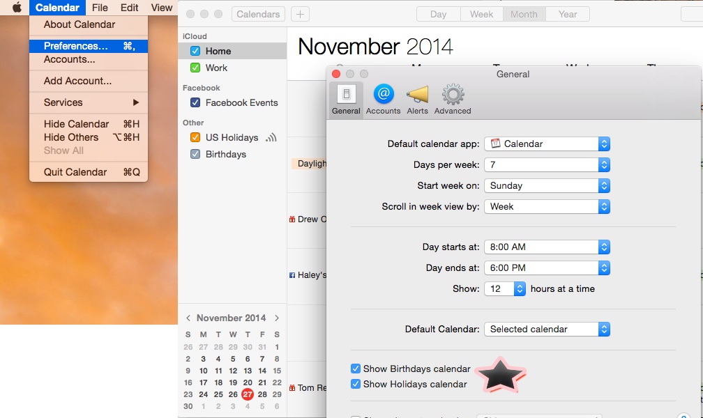

For those with a missing US calendar the correct/standard subscription link is:
https://p24-calendars.icloud.com/holiday/US_en.ics
(http://osxdaily.com/2014/04/10/show-holidays-calendar-ios/)
Can someone with a working UK calendar check their subscription and copy the link here. I can't find it anywhere but I know it starts with https://p11 or p21-........
