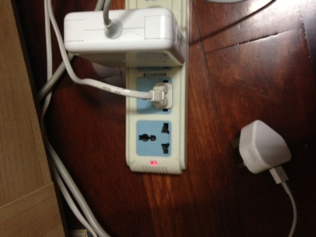

Absolutely no problem! I am living in Shanghai RIGHT NOW with all apple products. i ll show you a pic in my place and this kind of stuff is almost every. i guess it can fit with almost all kinds of adapter.

Thank you all for the helpful info. I discovered the same - that my US one is fitting just fine in these sockets over here. Why did I buy the World Travel Adapter Kit again? 🙄
