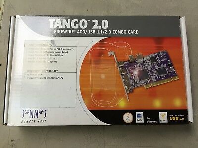

Hmm, that might be it. I will also try moving it to another PCI slot and see what happens. If not, I'll probably spring for this...
And hey, a couple extra FireWire 400 ports too!

One thing is for certain, while kinda pricey, Sonnet stuff just works in a mac ... well, let me step back and say I've never seen Sonnet gear not work in a mac. :D
Of course. Sonnet is the gold standard and that's also reflected the price of their products. :D
I have. I had a Sonnet Tempo HD card for Mac, which bizarrely had the PC firmware on it. I could find no way to flash it back to Mac compatibility and neither could Sonnet, so back to the seller it went.
