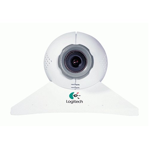

i too have a usb logitech camera and it works well with both my iMac G4 800 and the PowerMac G4 533 (DA). the caveat - one has to install those drivers and etc to get it detected on the macs. it is one of the very old quickcam express series from the early 2000s or late 90s.

My Logitech USB Webcam
TIFFADEE, the below is the pict of my webcam that i use primary with the iMac 800MHz.
source: Amazon
