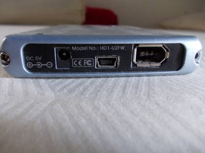

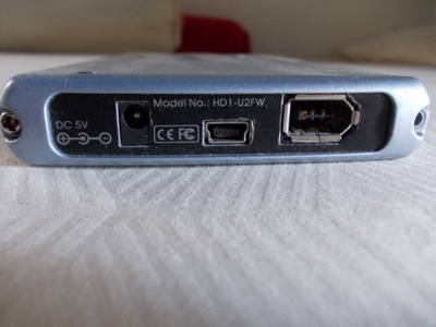

Yes there are portable FW drives as I claimed in my original post.
See Screenshot, a 2.5" drive.
This is a fairly old external casing, it is still PATA but there are also SATA enclosures with FW and USB.

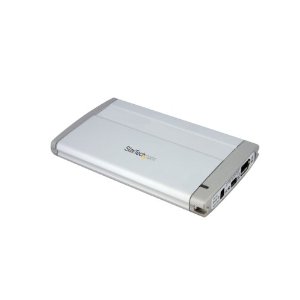

Startech.com 2.5 inch USB FireWire SATA External Hard Drive Enclosure
