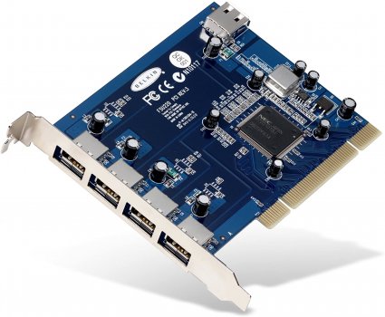

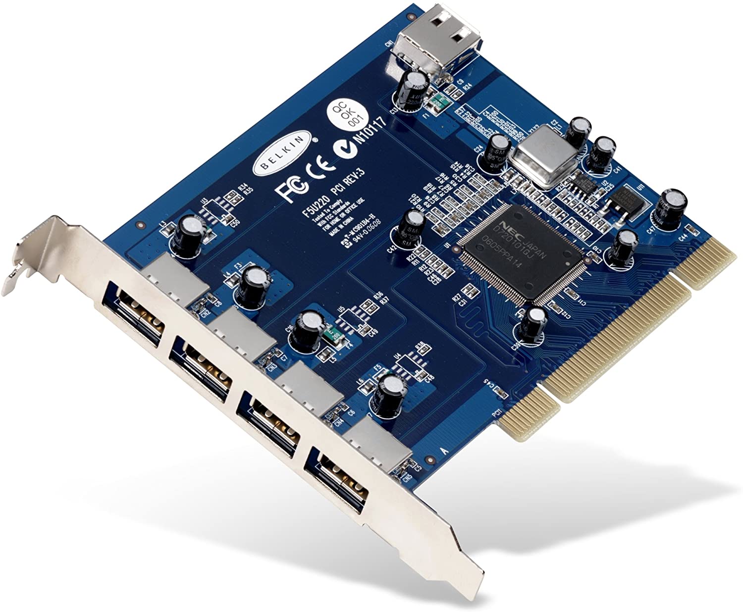

This Belkin F5U200/F5U220 card used to be the go-to card back in the day. It has the NEC chip. You may find clones of it with a green PCB.
