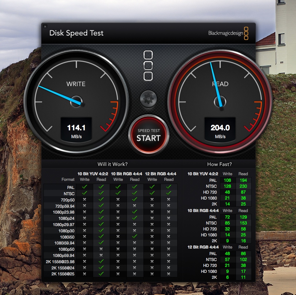

So I just installed the card and it worked right away. Here are screen shots of Blackmagic and the devices I used. I think it's right on the money, in terms of speed since I'm using my powered USB Hub in my Asus Pa248q Monitors.
Edit: maybe the write speeds would be a bit better if the card was itself powered as I see both are in the same ball park for write speeds. It could also be an OS thing I think. I'll test in Bootcamp and report back.

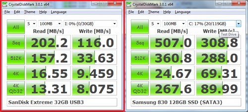

200MB/s reads from a thumb-drive... that's pretty good. I'd love to see what it gets in a small-file 4k test!!! Any chance of that?
Amazon has it for Windoze:
The SanDisk Extreme 32GB (left) and a Samsung 830 (right) for comparison.​

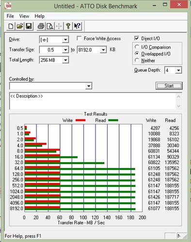

It's a really fast usb 3.0 drive. I get over 100MB write speeds. Do you want me to run a windows test under atto, or on mac (don't know the equivalent os x to test 4K)?
Yeah, the OS X test on a real Mac would be useful. I found some PC tests as you can see. I was thinking of buying 4 of these and putting them on the HighPoint USB3 4-port card in RAID0 and using that as a boot and OS drive. 😀
Sandisk Extreme 32gb:
http://www.sandisk.com/products/usb/drives/extreme/
I have the exact same 32GB Sandisk Extreme USB 3.0 drive. LOVE it!
Here are some Blackmagic benchies off my late 2012 i7 27 inch iMac with it:
