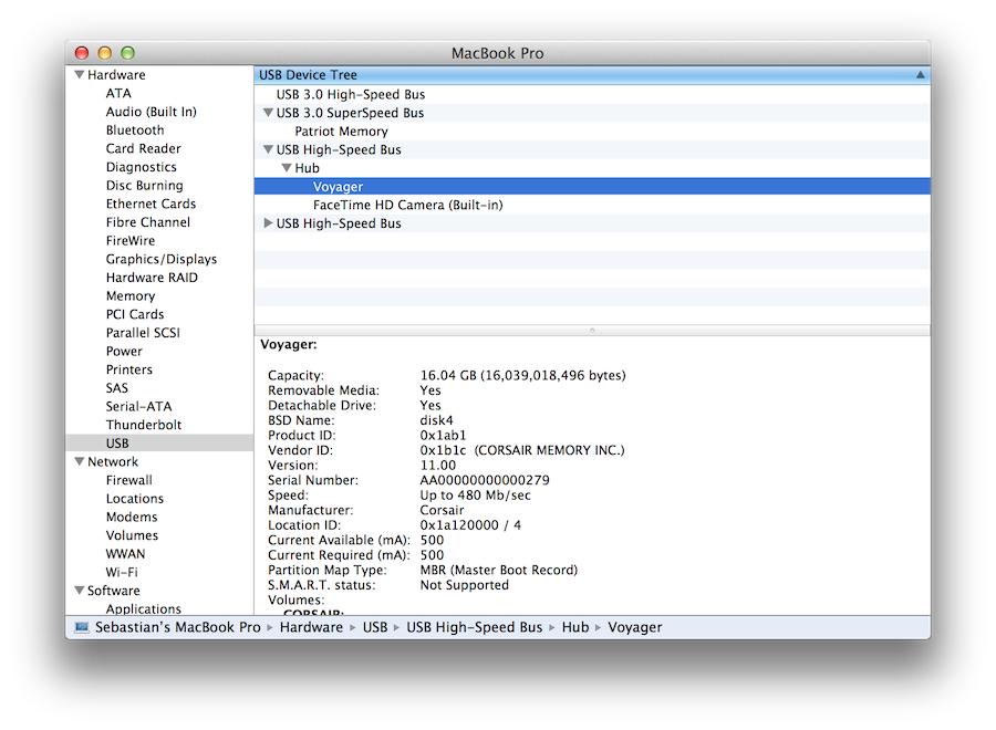

This is what happens when I connect two USB 3 Patriot flash drives.
They are both on the correct Superspeed bus
This is when I connect a USB 2 Corsair flash drive in the one port and a Patriot USB 3 flash drive in the other port.
I expect the MBA to be working in the same way.
