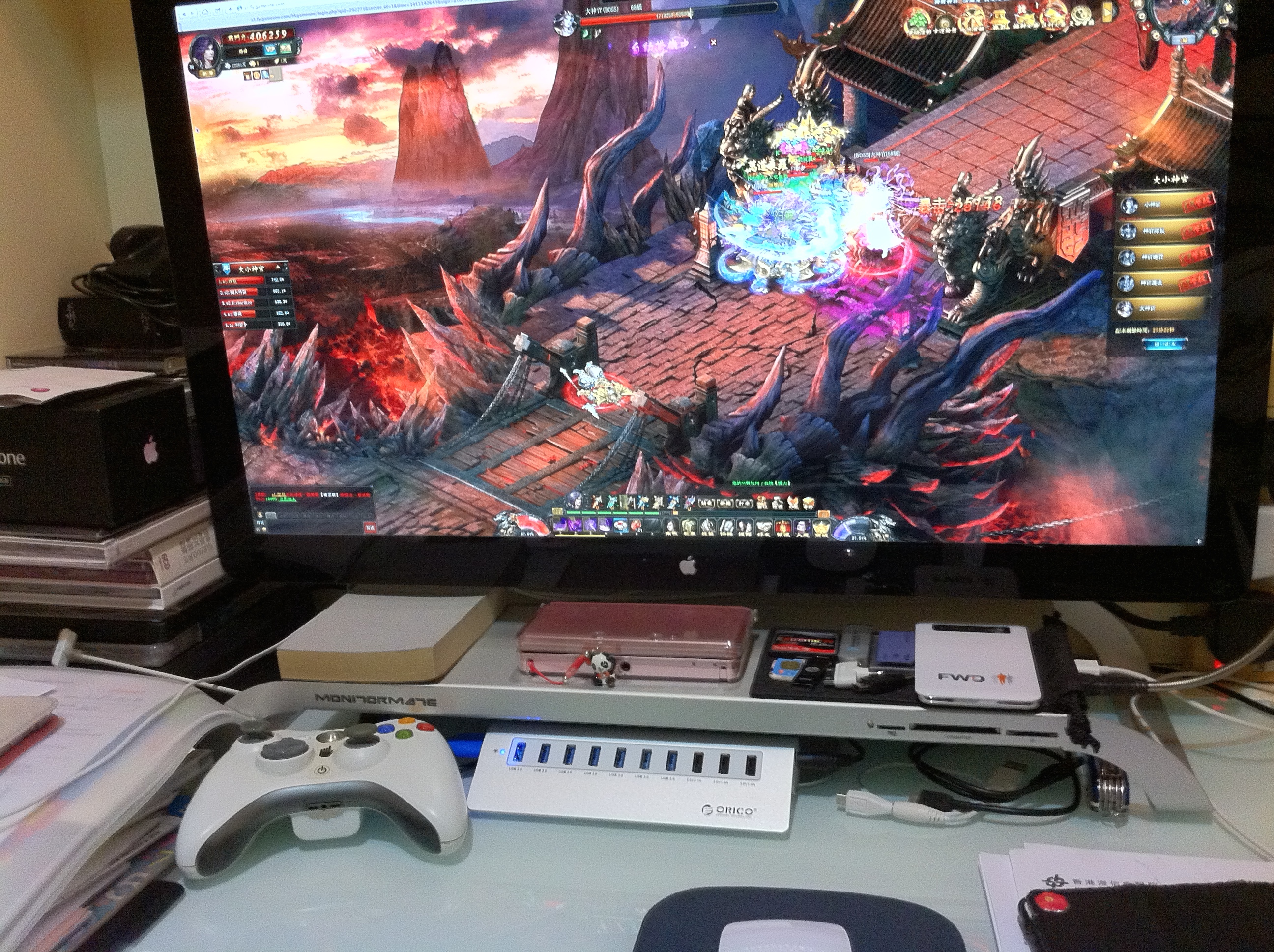

Anyway, this is my setup.
A Monitormate ProStation 3.0 dock as a card reader, USB 3.0 hub (5 data ports + 1 charging port), and ext USB HDD storage. This is mainly for some permanently connected device.
An Orico 10 ports USB 3.0 hub (7 data ports + 3 charging ports). This is for easy access.
There are 12 USB 3.0 data ports + 4 charging ports in total, and most of the cables are basically concealed.
That MONITORMATE ProStation 3.0 is $1688.00. I bet you like it, but that is insane!

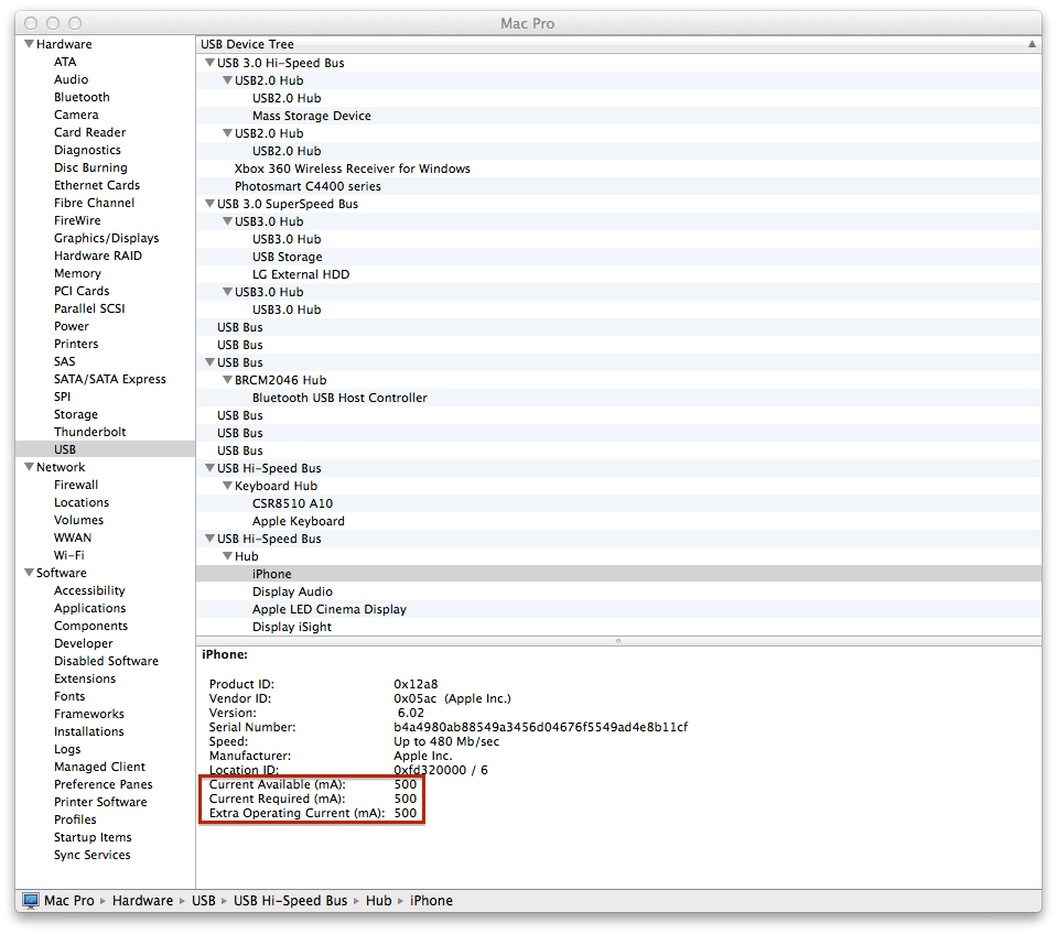

^^^ You can check the total current in system profile. So that you can compare the difference with and without the power supply, or if that's better than the direct connection.
However, only the data port will be displayed. The charging port won't. And you can only assume the charging port is delivering the designed current.
