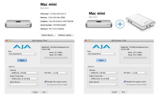

the vendor has a test on transfer rate with an external SSD on Mac mini of mid 2011, which has only USB2.0 system.
This is the result:
Through built-in USB 2.0: write 25.7 MB/s ; read 34.7 MB/s
Through Dock's USB 3.0: write 251.5 MB/s; read 351.3 MB/s
This is the result:
Yes, the 2011 Mac Mini has only USB 2.0 (no USB 3) but that is completely irrelevant since the Akitio Thunder Dock connects to the Mac via its Thunderbolt port. You cannot get USB 3.0 speeds through a USB 2.0 port.
Well post #6 would seem to prove that a USB 2.0 computer can in fact see USB 3.0 speeds, at least with that particular hub.
See above.
