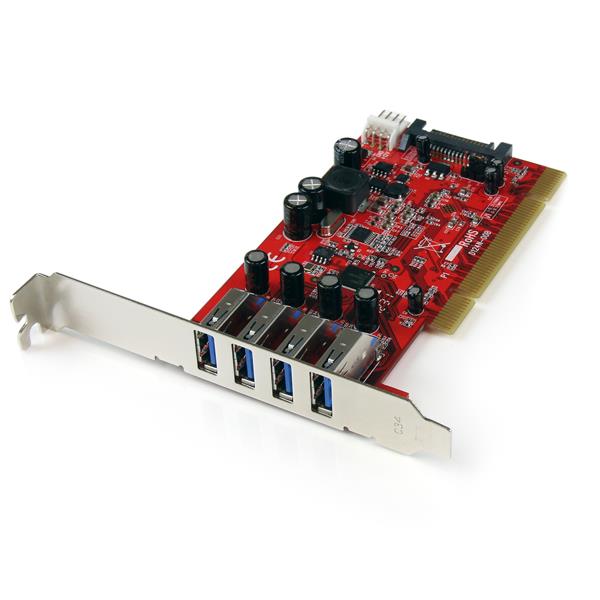

Startech.com PCIUSB3S4
4 Port PCI SuperSpeed USB 3.0 Adapter Card with SATA / SP4 Power
Have you tried this card?
Who are you replying to? I doubt that OP cares after 8 years, if he is still around. As for this card, the spec sheet
sounds discouraging:
OS compatibility.
Windows® XP, Vista, 7, 8, 8.1, 10
Windows Server® 2003, 2008 R2, 2012, 2012 R2, 2016
No drivers mentioned for OSX, let alone PPC. Not all xHCI cards play nicely with MacPros.
Don't look at the OS Compatibility..it has the Renesas/NEC - μPD720202 chipset !

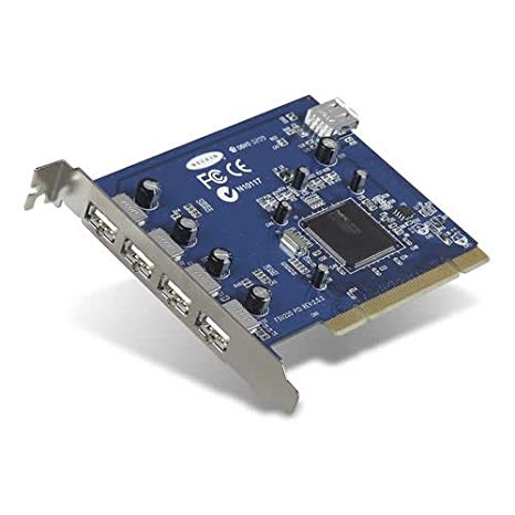

What i'm actually looking for is full speed 480mbps on all 5 ports simultaneously and this one along with the Belkin USB 2.0 5-Port PCI Card F5U220 looks like it just might.
What i'm actually looking for is full speed 480mbps on all 5 ports simultaneously...
I've never seen anything that could saturate the theoretical maximum throughput of a USB 2.0 bus, although I've noticed USB 3.0 devices typically greatly exceed speeds of USB 2.0 devices when run on the same USB 2.0 bus. That might be the best you can do.
It would be a remarkable achievement if you could reach 480 mbps. I doubt it's actually possible, but good luck!
